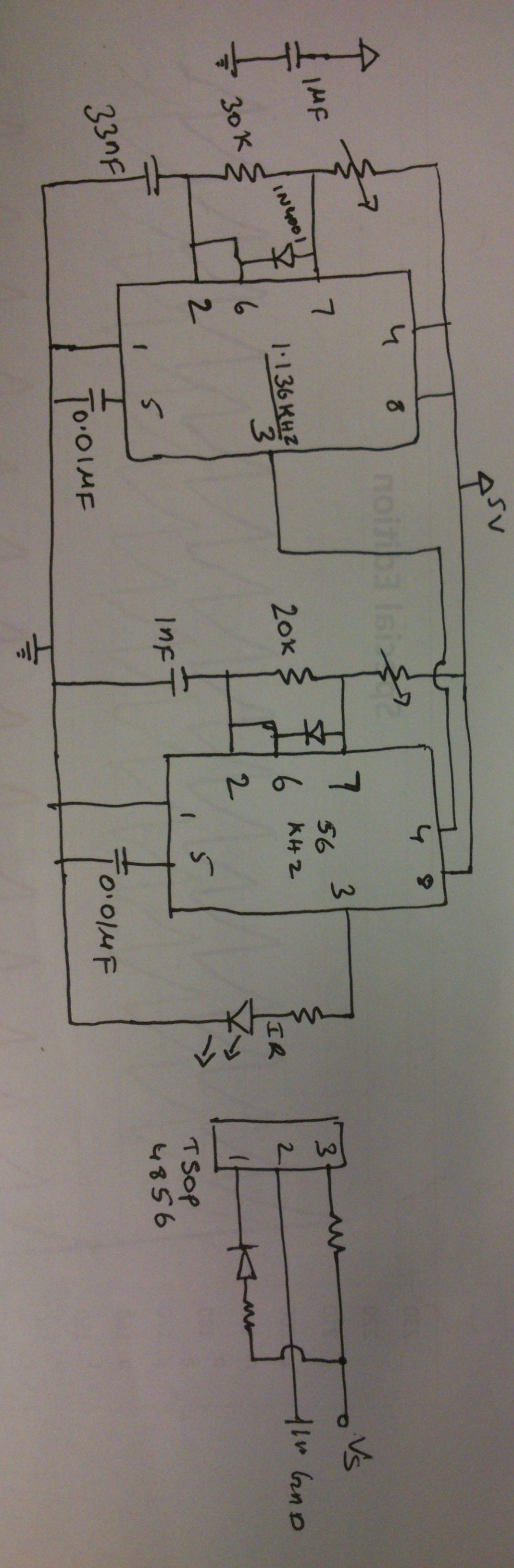

I have tried reflective type by modulating the signal. I used TSOP56 at reciever and two 555 timers at transmitter to send pulses of 56 khz signals. But the output led is ON irrespective of the obstacle. it goes OFF only when i remove the ir emitter off the circuit. I have also sheilded the ir emitter. but doesnt work. Do you have any idea about my mistake. I have attached my circuit. plz let me know.
This is a file containing about the circuit and some description which is used in the device. I am confused and could not undersatnd properly what is going on. . It would be helpful if someone could suggest me a solution with my problem

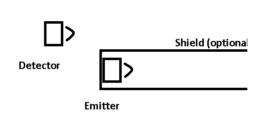

It sounds like your detector may be getting too much scattered light from the emitter to ever turn off. How were they arranged physically? In a similar project, I had to have the emitter in front of the detector. An opaque tube around the emitter may be necessary. I used a 6-mm aluminum tube for that. A paper tube covered with black vinyl tape will also work. Can't find a picture of that project, but here is a rough drawing:
