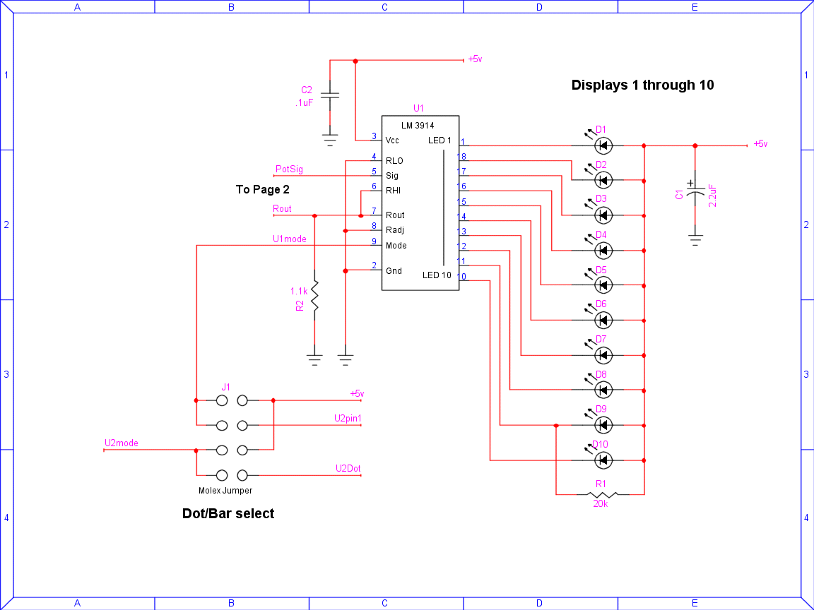

If pin 9 is not connected (default), it will be in Dot-Mode. Connect pin 9 to pin 3 (+ on power supply) for Bargraph

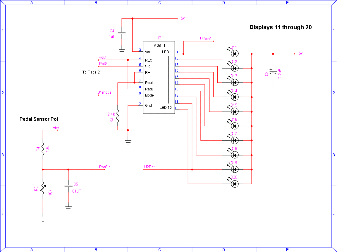

Okay, as promised, here is a circuit I drew up. I may have made a few errors as nobody is perfect I am sure if I did, it will be pointed out. Anyways, I attached the schematics and sorry, it took two pages to fit everything. The jumper block is to set between Dot mode and Bar mode. The nets with labels simply means tie those point together. Hope that helps...

Ack, I already spotted one error. Pin 9 of U2 should be U2mode. My printer is out so it is hard to catch everything from the monitor
I will correct the error later as well as check it over one more time...

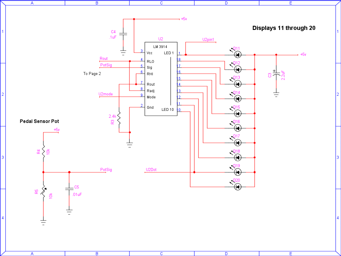

Just to keep things ship shape and all that sort of thing I corrected an error, added a note for the jumper block, and updated the schematic. So here is the latest for your use

Oh, and here is a somewhat of a parts list. You need to pick your LEDS. Low current ones I would suggest.

See the +5v inputs, is that the max voltage a lm3914 will take, as it would have to run off 12v from the car.

Ugh, your correct in your thinking. You want twelve volts, but the circuit I gave was for 5V (Will work at twelve but components values may need to be changed). I kinda assumed you might use a 5v voltage regulator like
The Auto voltage is rather a noisy world and straight 12-14vdc from the auto might cause noise issues in the circuit (Such as sporadic led operation). A regulator would help clean up the standard auto volts.
