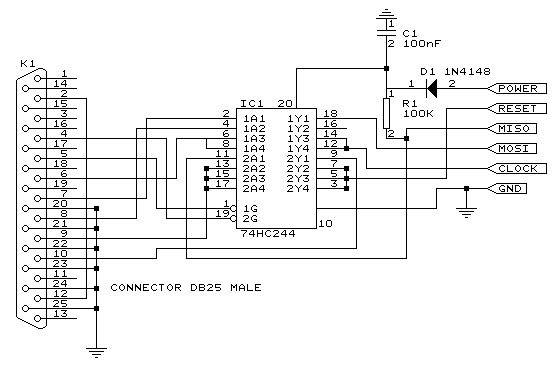

I'm searching for an STK300 compatible programmer which is really easy for you to build.Only a few resistors and a 74LS244 is needed.AVR Studio will support it.
It's here,the circuit is as below,really easy to DIY.
The latest AVR Sudio doesn't support it.You need Code Vision AVR or ICCAVR.I have the CVAVR setup and crack files(1.8MB),as well as the ICCAVR setup and crack files(11MB).If you decide to build the STK300 yourself.I can send you the installers via Email.Neither of them has ATtiny15L in its support list,but they support tiny13.It's a headache.You need a new HEX for them.I can write the C project for you.Anyway it's getting complicated.You better try the 555 toggle solution first.If it works,forget the AVR.If you're not saticfied with it,come back here.

How about something like this. Only 1½ ICs 2 capacitors, 5 resistors and 2 diodes.
The values of r1c2 and r3c1 would be chosen to give 20mS.
The value of r2c2 would be chosen to give a closed pulse.
The value of r4c1 would be chosen to give a open pulse.
r2 and r4 should really be variable.
As a starting point for the values, I'd try,
C1,C2 = 1uF
R1,R3 = 37k
R2,R4 = 5k preset variable.
Edit - added guessed values!
