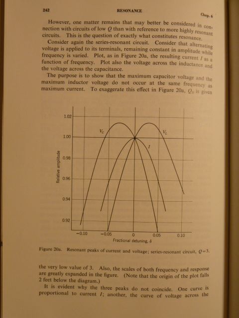

The first attached image gives some discussion from a circuit theory text:
The second image gives some discussion of phenomena associated with the series resonant circuit:

For proof that these peaks exist and are different, we analyze the circuit for the
three different AC voltages. The results are as follows...
Let D=sqrt(w^2*C^2*R^2+(1-w^2*C*L)^2)
then the three voltage amplitudes are:
vC=1/D
vL=w^2*L*C/D
vR=w*R*C/D
From my previous post, the three different angular frequencies that cause the peaks are computed:
for max across C:
w=sqrt((2*L-C*R^2)/(2*C*L^2))
for max across R:
w=sqrt(1/(L*C))
for max across L:
w^2=-2/(C^2*R^2-2*L*C), w=sqrt(2/(2*L*C-C^2*R^2)) {condition 2*L>R^2*C}
So we immediately see three different frequencies as well as three different amplitude
equations. Next we could insert each w into each respective amplitude equation and
we could calculate the three normalized peak voltages:
max across C:
vCmax=2*L/(R*sqrt(4*L*C-C^2*R^2))
max across L:
vLmax=-(2*L*abs(C*R^2-2*L))/(sqrt(4*C*L-C^2*R^2)*(C*R^3-2*L*R)), {condition 2*L>R^2*C}
max across R:
vRmax=1
It might be interesting to note that under certain conditions the max across C is the same as the max across L, but they occur with different w. For the example i gave before with L=1mH, C=10uf, and R=1, this can be observed.

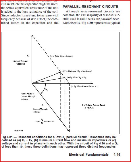

The Electrician,
If the circuit is a pure series RLC circuit, isn't "cancellation of reactance" the same thing as zero phase angle between the terminal voltage and current?
One would think so, but it is not for a parallel resonant circuit. See the figure description of the attachment.
Ratch
