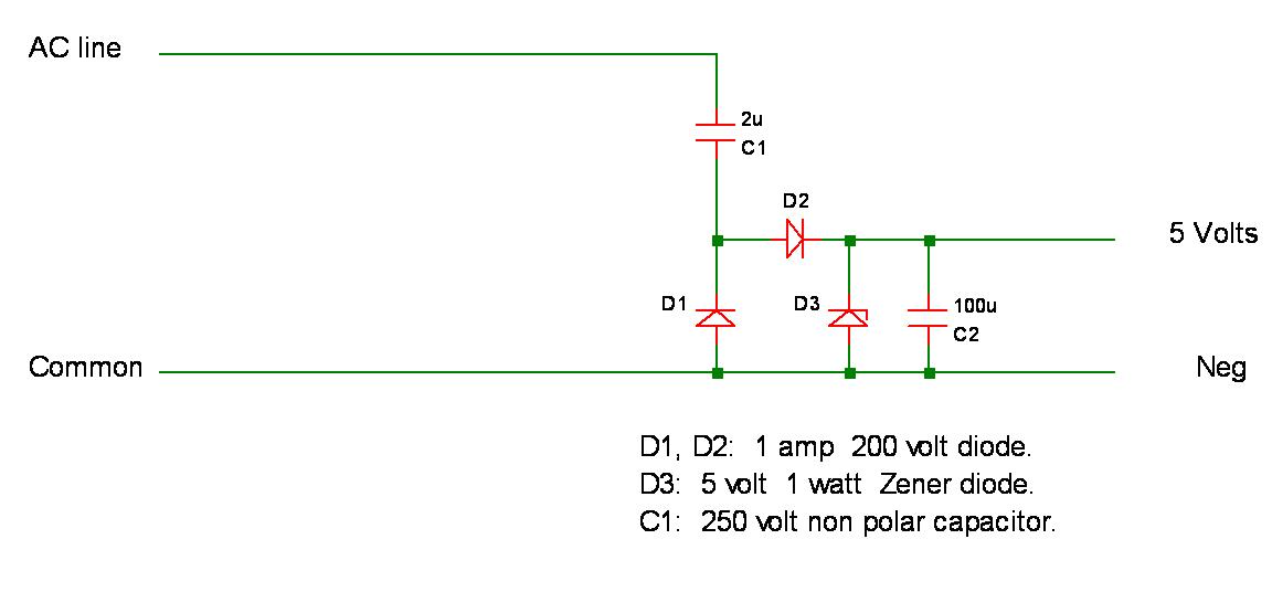

I guess I'm not as concerned about the transformer. That is something I could work out later. What I need right now is a chip. Do you'all know of any cool chips where I could run the AC straight into the chip and just have a few external parts to pull it off? I mean, I could do this using a diode bridge rectifier and all, but I know there are allot of chips out there that have all that in them. Maybe Maxim would have one. I'm just sorta tapping the knowledge banks of the group, where maybe someone has done something like this recently so I can go after the latest & the greatest.....cheap and small.
One of the Microchip app notes shows a transformerless PIC supply. A few caps & diodes. Problem will be the size of the 1uF high voltage cap.
Thats an easy one!
This is as simple of regulated power source you can get thats directly line powered.
The AC cpacitor value should be matched to give you about 20 Ma or so higher than what the circuit uses at peak amps draw. :)

Sure, use tantalum caps if you want to create a small ball of plasma where your pic used to be the first time the power line spikes. You could use a simple non-isolated buck converter, the Art of Electronics has an example on how to build a line powered buck converter which could probably be adapted, again though for 100ma's a standard transformer/bridge rectifier is really not that big. you're only saving 50% space and some weight at most.
Am I missing something? Where did the idea for Tantalum Caps at 250 VAC and what not come from?
