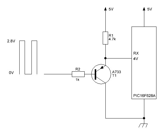

I'm Reading a UART stream which has voltage levels of 2.8V Max & 0V & the reception is done using a 5V UART PIC.PIC UART receiver has a schmitt trigger input so it is expecting 0.8*5V = 4V to receive data properly.I made the below circuit but sometimes its not working. How to bias it properly?

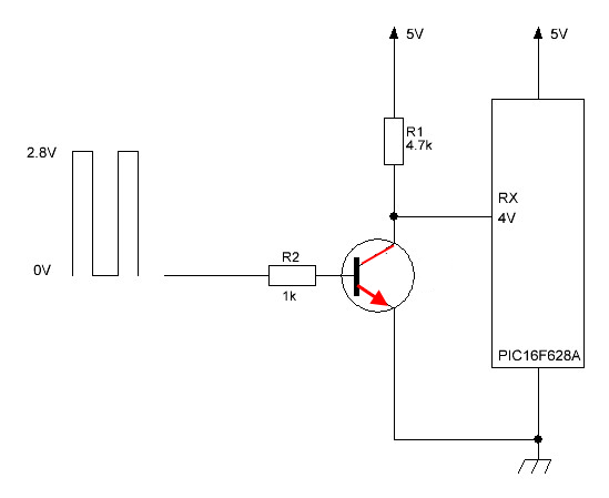

Your circuit is doing little because it's a common emitter circuit (I'm surprised it works at all?), with an NPN transistor (and the other way up) it will work properly, BUT will invert the signal - can you invert the source in the code there?, or use a software UART in the 628 where you could invert it in the software. Or use a more modern device that allows inversion of the UART hardware.
However, you say the incoming signal is 2,8V?, is it from a 3,3V device?, because RS232 from 3.3V devices normally works perfectly on a 5V PIC.
I changed the 'sex' of the transistor. What you had, the transistor will be on all the time.

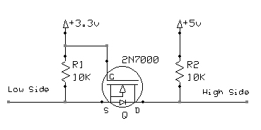

There are many diagrams of level converters between 3.3V and 5V using a simple MOSFET:
You can buy 2 or 4 port level converters ready made on places like Amazon or Ebay. These are bi-directional, so they can be used to receive or send, but can also be used in one direction only. I use such a level converter between a 3.3V GPS and an Arduino in receive mode only.
PS: Sorry, I posted the same image as the link previously posted by Spudboy, I just never followed the link till now...

The UART data coming from a SIM800L GSM module. The incoming UART signal has 2.8V max voltage.All this time I did with a PNP transistor method.It worked.But the levels are in the marginal.Not enough to capture the signals from the PIC.Because PIC sees 2.8V + 0.7V = 3.5V not enough.
I'm using hardware UART.I have some large SMS strings to be read.Home workbench its working but in the site environment the SMS mostly fails to capture by PIC. :( I need to stick with the same PIC16F628A.
OK thank you very much for the info.
I don't see how the PNP version could ever work?, a better option would probably be a simple silicon diode rather than a transistor, which would give the 2.8+0.7V. Can you confirm that you've tried it with nothing?, and that it wouldn't work like that.
If it won't, then use the FET version shown above - or run the PIC at a lower voltage? - I presume you're attenuating the PIC output to the SIM800?, or you'll kill it.

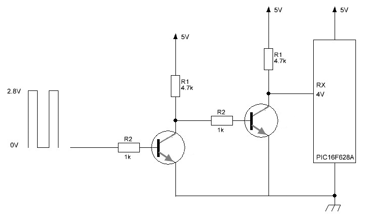

When I lower down the supply voltage to 4V it worked nicely.I changed my entire PCB design & made the changes like "Spudboy488" mentioned (Two transistor version).In this time also the power supply is 4V.
