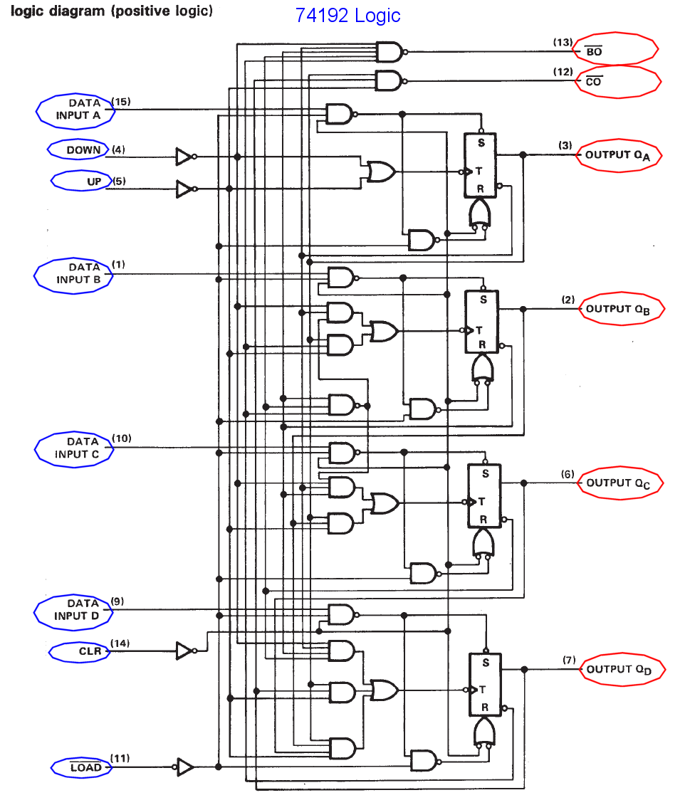

Firstly, please bear in mind I'm a complete novice taken up a new hobby and trying to get my head round some very confusing stuff. I divide my hobby time between building a project I've already thought through and planned with the help of you guys and thinking through, planning and understanding the next project.
My next 'thinking project' is to do with countdown timers. I built a countdown timer based on a PIC 16F628a which counts down from 5 discreet bases 8, 16, 24, 32 & 40 mins using code provided for me by a Picprojects kit which works very well. I now want to understand how to build a countdown kit with 7 segment LED displays which can be preset to the same bases and will display the countdown. I've got a schematic drawn by one of the members on here which uses a 74LS192 IC up/down controller and I decided the best thing to do first was to understand how that chip does what it does ! I downloaded the datasheet which has a narrative of it's operation and also a graphic circuit diagram of the logic gates contained. I've read the chapters on logic gates in my books 47 times and decided I was now ready to try and understand the chip.
Failure !!!! - the diagram shows some of the logic gates with 6 or 7 inputs !! My books show only two in most cases - so some must go to one input and some to the other ? But there is no indication how this is done so how do I work out what will happen when a high or low + or - arrives at an input ?
Since this is more about me learning than the optimum operation of a digital countdown timer, I'm not interested in changing the schematic to another project, I just simply want to understand how this one works by developing my own analysis skills.
A suggestion of where I'm going wrong would be much appreciated

With only a focus on the 74192 PRESETTABLE BCD/DECADE UP/DOWN COUNTER. The link is to a relatively good data sheet. Here is what the logic looks like:
I circled the inputs in Blue and outputs in Red.
Now using the above image as a reference for the 74192 what questions do you have? :)

My confusion - for example - at the very top of the graphic there two NAND gates, one with 5 inputs and one with 3. This situation occurs on many occasions although the gates are sometimes different. I want to understand what a signal will do but there is no indication of which input is which - may not matter with a NAND because the signal on either would pass high but on both would pass low ?

For a NAND gate, e.g the top gate in the above pic, all the inputs (however many there are) must be high for the output to go low.

An input or output with a bar on top, indicates that this I/O is active when it is in the Low state.
I hope that this helps.

JimB thanks for the definitions - that's very helpful in understanding the IC as a whole which I need to do. However, what I was trying to do is to establish the 'why' element, ie. a logic high on input 'UP' will increment the count output - if you follow the circuit through the gates you will see that ?? Not in my eyes !
Input B has two AND gates with two NAND gates either side of them - each has 3 connections but no indication of which is where, so how do I access and understand the behaviour of these gates with differing signals and then interpret the effect on the OR gate that follows - and one of those has 3 un-labelled connections.
On a slightly different note - I've decided that the rectangle boxes on the right of the IC scheme are SR Flip Flops and 'T' is a trigger ?? Tell me I've got that wrong too !

Musicmanager, You picked the hardest counter to understand.
This is a ripple counter. Very simple. It is called a ripple counter because the first FF gets a signal and (1/2) the time then (with a tiny delay) sends the clock on to the next stage. The clock "ripples" down the line.
This counter does not ripple. All FFs have the same CLK so they all work at the same time. (will count faster)
Here they are using JK-FF. If you tie J and K together you have a T-FF. {there is a single T input} When T=0 the output holds. When T=1 and there is a rising edge on CLK the outputs toggle. (reverse state)
Note the UP/DOWN input connects Q or /Q to the next stage. This is the same as connecting Qa to Tb OR Invert Qa and send to Tb. (T=JK)
This counter looks much like the one you are working on. Add SET and RESET and LOAD makes it hard to understand.
The SR Latch or Flip Flop comes in 2 flavours, one is just the bare SR latch or SR Flip Flop, the other, the one here in this case, is often called a Gated SR Latch or Gated SR Flip Flop, because the outputs are only activated when the Clock or Trigger is active or, when the "Gate" is opened, so to speak. So you are correct, it is an SR Flip Flop, with a Trigger input, it's just not called that! They are usually built using more basic gate types, either 4 Nand gates or 2 Nand's and 2 Nor's. There is a caveat to using them, however, in that there is a special logic combination that needs to be avoided during operation, which would be all inputs at logic 1. JK Latches or Flip Flops were designed to overcome this little shortcoming. There's also other types of Flip Flop like the D-Type, and in some respects, your counter is very similar in logical terms. There are some good texts on the workings and principles of SR and JK Latches on the web. Welcome to the wonderful world of logic, or not :)
SR = Set Reset
T = Toggle rather than Trigger

One thing you may not be aware of: in the post #2 pic the little circles at the gate/FF inputs/outputs denote logic inversion. In the case of the FF, for example, logic low triggers the FF to toggle, and the FF has two complementary outputs.
