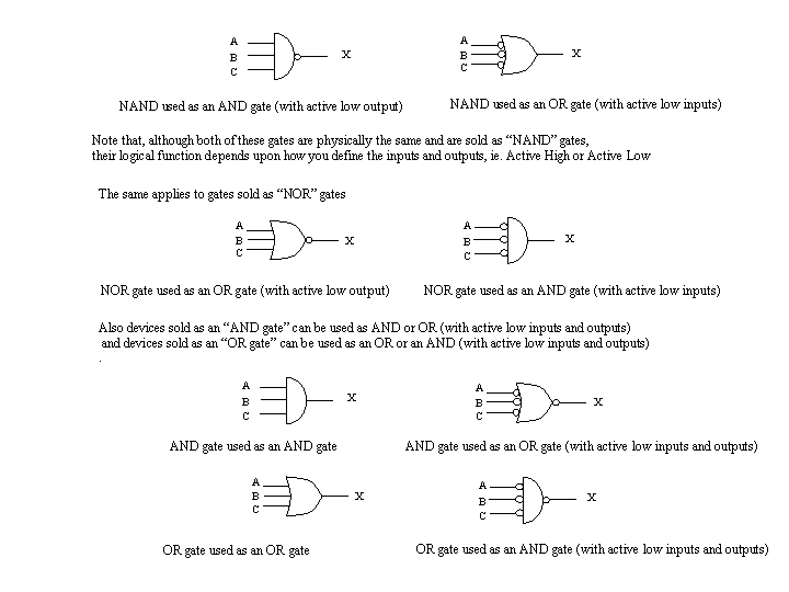

0 and 1 can be confusing since in positive logic, 1 = high & 0 = low but in negativelogic, 0 = high & 1 = low.
So it is less confusing to use "active high" and "active low".
eg. when a NAND gate is used as an AND gate it has active high inputs and an active low output. Or if it is used as an OR gate, it has active low inputs and an active high output.
