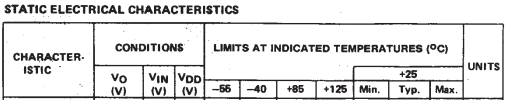

Yeah about the LED and the input... It is not the best idea.. But it worked out on the board.. But those LEDs were actually more for me to understand and see how it actually works.. But if I did actually need and output which both gives a Light(like signal that it is on) and at the sime time i want to give it a signal to another output pin.. How should this be done then? Is there a better way for than i did on the circuit?
Yes, a resistor in series if you still want the proper logic levels to appear at the output.
Here's the part of the data sheet that pertains to the output current for a grounded load: View attachment 107451
You can see that at a 5V supply the highest worst-case current load you should have at 25°C, and still maintain a good logic level, is 0.51mA.
For an LED with a forward drop of 2V, this means you need a series resistor of no less than 3V/0.51mA = 5.9kΩ.
For a transistor with an input Vbe of 0.7V the resistor should be >4.3V/0.51mA = 8.4kΩ

An LED with a current of only 0.51mA will be very dim. That is why I said that an ordinary Cmos gate with a 5V supply cannot drive an LED and have a logic high voltage at the same time. The gate can easily provide a low input current to a transistor that can provide plenty of current to the LED then the logic high voltage will be fine.
Why is the value of your current-limiting resistor R3 only 200m ohms which is 0.2 ohms and is the same as a piece of wire? If the LED is a 2V red one then the 0.2 ohms will have a voltage drop of only 0.51mA x 0.2 ohms= 0.0001V!
Actually, the datasheet shows that logic levels for ordinary Cmos gates using a 5V supply are a minimum of 3.5V for a logic high and a maximum of 1.5V for a logic low.
