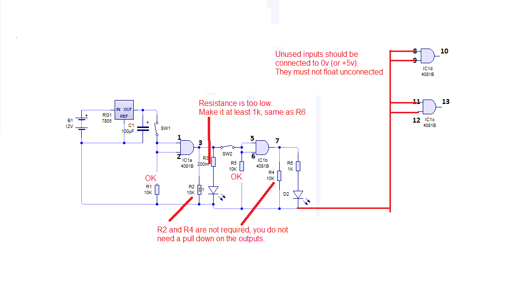

What i just tested on my breadboard is this: Sorry I tried paint but it was awefull my drawing.. And can't take a pic.. The program doesn't desplay the whole thing and ofc 7 and 14 are Vcc/GND
This way i tested it and it worked... But after reading your comment i got confused maybe it worked but not on the good way? so I should of added the pin 11/12/13/ 8/9/10 to the GND? And to The leds i have i should connect 5K resistor?
And the last quote which i really didn't fully understand is that i shouldn't have connect any of those 10kResistors? and should have connected them to the 11/12/13/ 8/9/10 Pins?
BTW: This circuit didn't workout on the program... (i think because of the less volt going to 5/6? But on my board it worked.. )

When you do, look at this:
EDIT
In view of the information provided by Crutschow in post ~#18, resistors R3 and R6 should be of higher value, ie not less than 5.9k for correct operation within the limits of the IC.

The 5k resistor should be in series with the LED.
I still didn't understand this one... The one Jimb just mentoined and said I should have it 1k? The r3 and r6?
What is the reason for it even to be 1k? at 5v? And why that one 5k? Was this because of the max output current ? so the Resistor will make the flowing currect lower?

From the datasheet, the maximum output current the gate can source or sink (Ii/o) is 10mA, subject to a maximum power dissipation of 100mW per output. At that current the output voltage won't be the normal logic high or low, because of voltage drop within the gate. But it's not usually a good idea to work to the device limits. If you restrict the output current to about 1mA then the output voltage will be close to the full logic levels. 1mA of base current in a BC337 should enable at least 100mA of collector current to flow.
So basicly with any load we put on the output pins, we should put an resistor on it based on the current the load used as example a LED/transistor?
Even if the flowing current is under the max currecnt of the out pin?
Yes, a resistor in series if you still want the proper logic levels to appear at the output.
Here's the part of the data sheet that pertains to the output current for a grounded load:
You can see that at a 5V supply the highest worst-case current load you should have at 25°C, and still maintain a good logic level, is 0.51mA.
For an LED with a forward drop of 2V, this means you need a series resistor of no less than 3V/0.51mA = 5.9kΩ.
For a transistor with an input Vbe of 0.7V the resistor should be >4.3V/0.51mA = 8.4kΩ

You show some of the pin numbers WRONG and you are trying to drive an LED and have a logic high voltage at the same time.
