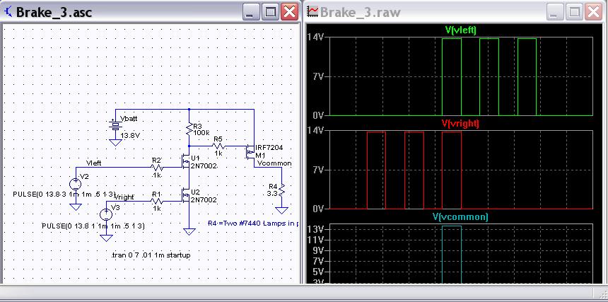

Logic circuit third brake light.
That circuit lights the 3rd light only when both inputs are on.
If the inputs were brake-light-only, there would be no need of the circuit: it could be replaced by two diodes
Don't even need the diodes.

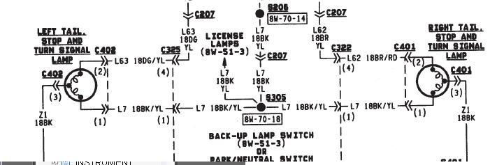

Here ya go: 1995 Dodge Dakota
Lots of pickup trucks have the bare-minimum of colored plastic in the rear corners.
I can't give you numbers because it's not something that's indexed (as far as I know: prove me wrong, Internet!)
Admittedly, they're getting rarer... and apparently about to disappear
https://www-nrd.nhtsa.dot.gov/Pubs/811115.PDF
... says that amber turn-signals are 'slightly better' at preventing rear-enders than are red.
All the US manufacturers would need to do is equip the domestic production same as the exported.
A pickup truck is missing many safety features that are used on cars. There isn't much space for rear lights so they simply combine them on each side.

Here's another circuit that might suit:
That circuit will blink the 3rd light when the brake is applied and a turn-signal is blinking. You want a circuit that will maintain the 3rd light steady under those conditions, thus you need a memory circuit with some type of latch, such as I previously posted or the Third Brake Light SCR circuit that Tricky posted.
Whoops, had wrong circuit before. This is the one I meant.
