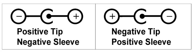

The long bar with three dashes under it is the symbol for a DC power source input (as opposed to AC). For an AC-to-DC adapter to work for you, it needs two things:
1) The correct polarity. Most are center-positive. That is, the center pin is the connection for the + connection, and the barrel around it is for the - connection. There is a symbol near the DC input symbol that has the a line from the pin to either a + or -, and a line from a surrounding "C" shape to the other polarity. If you can, photo that and post it.
118963
2) The correct pin size. There are several different combinations of pin diameter and shell diameter. This usually is the main problem when buying from ebay or amazon. I love ebay for things like this, but make sure the vendor is in Ireland and has a return policy.

Yes, what I said was I have sitting here a HP power supply. Input voltage is 100 to 240 VAC 50 to 60 Hz. Output voltage is 18.5 volts 3.3 amps so it's about a 60 watt supply. The line cord plugs into one side with a standard US 120 VAC wall outlet plug. The DC out is a standard cord with a 5.5mm DC Barrel Plug.
HP Part #239427-003
The problem is I am sitting here in Cleveland, Ohio USA. I have no idea how your customs work on postal stuff. I have no problem sticking this thing in a small cardboard box and mailing it. I do not do pay pal but as far as I am concerned you can have the thing, I will likely never have any use for it. The problem being if I send it international mail you will likely get hit with customs on your end.
