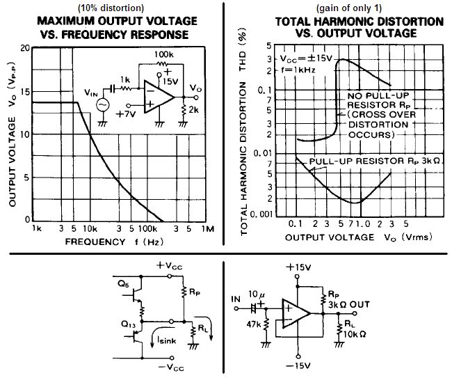

The LM324 is only 3 years younger than the 741 and is 34 years old today. It is also has a low bandwidth and high noise. Because it is low power it has terrible crossover distortion.
Mutsubishi copied the LM324 and explains the 3% crossover distortion (at a gain of 1, it is even worse at higher gain) and a method to reduce it.

What did you mean by explains 3% crossover distortion,did you mean that LM324 has a 3% distortion out of 741's?!

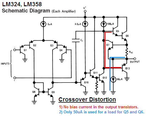

Correct. To allow the amplifiers in an LM324 to have low supply current, the design uses NO bias current in the output transistors like normal amplifiers have. It has a constant current sink of only 50uA to operate Q5 and Q6 in the class-A mode to reduce the crossover distortion when the opamp doesn't have a load.
If the output is capacitively coupled or the opamp has a dual supply, then Q13 is never turned on until the negative-going load current exceeds 50uA. When the negative-going load current exceeds 50uA, then the drive voltage to the bases of Q5 and Q13 must suddenly change about 2.1V which causes severe crossover distortion.
To reduce crossover distortion, National recommends adding a load resistor to ground to provide more current for Q5 and Q6 to remain operating in the class-A mode.
Mitsubishi recommends adding a load resistor to the supply so that Q13 operates in the class-A mode.
Both recommendations result in the opamp using much more supply current.
