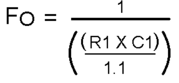

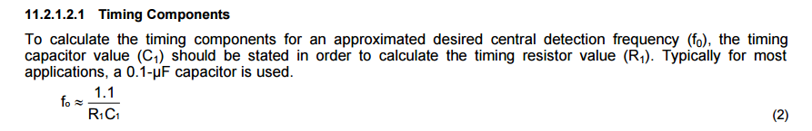

chemelec said:
Ti is Different.
Ti Formula Multiplies the C1 R1 result by the 1.1
Mine Divides it by the 1.1.
This (chemelec):
And this (TI):
are identical.
1
___ = b/a
(a/b)
John
Edit: Maybe we are looking at different datasheets. This is from the one posted by Kubeek:
I Used a .1 uf Cap but with Various Resistance Values and got Correct Frequencies on my Frequency Counter.
