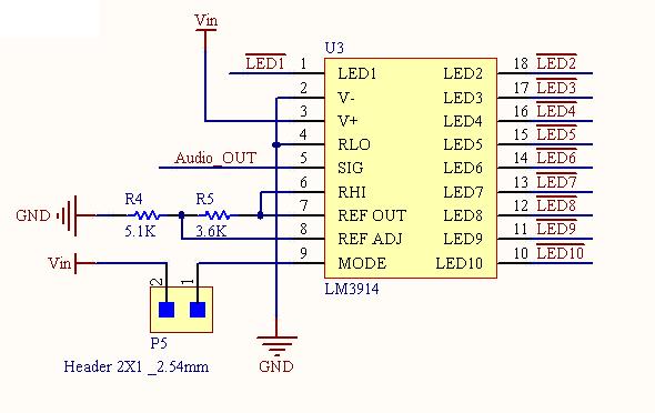

hi everyone, I have a question about setting the reference OUT of the LM3914. I am using a 5V power for my project and I would like to set the Ref Vout to detect 3.0V at peak level. I used the equation Ref Out V = 1.25(1+ R2/R1), R2=5.1K, R1=3.6K. I expect to see a 3.02V in pin 6&7, however when I measure it, I got 3.32V. Does anyone can help me with this issue??
On page 8 of the LM3914 Datasheet, I saw another equation Vout = Vref*(1+R2/R1) + Iadj*R2. How can I calculate Iadj??? which formula should I use?? the first one or the second one???

Thanks ericgibbs, the calculated RefOut value by your calculator is exactly what I expected to see, but in real life, I got 3.32V on the RefOut (pin 7), do you have any idea why?
Post a diagram showing your circuit.
Here is it, Vin is around 4.8V

With R1= 3.6K and R2=5.1K it should give a pin7 voltage of 3.02V
If R2 is actually a 5.6K you will get 3.2V, I would check the value of R2.
I checked it many times, R2 is 5.1K.
Anyway, do you know how to calculate Iadj from Pin8?
In the LM3914 datasheet page 8, Vout = Vref * (1+R2/R1) + Iadj*R2
Thanks for your help
I just checked the current Iadj with a meter, the reading is around 60uA,
Vout = Vref * (1+R2/R1) + Iadj*R2 = 3.02 + (60uA * 5.1K) = 3.32V which matches the measured Vout value, However, does anyone know how to calculate Iadj??
Look at the datasheet REFERENCE graph plot and the Adjust pin current.
It has a range of 75uA to 120uA
If you have 60uA then the second term, Iadj * 5100 = 60uA * 5100 =.306v
and the first term Vref[1+R1/R2] = 1.25 * 2.41 = 3.02V so that gives a Vout of 3.32V which is what you are measuring.
Its important to note that there is wide spread in the parameters of the LM3914.
I would recommend that R2 is a variable resistor, in your project a 10K could be set to give the required Vout/ref
