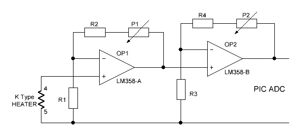

I need to amplify K-type Thermocouple reading to 0-5V range.This is the range that I need to amplify.
K Type Output Readings
0'C to 250'C
0'C =0.0 mV
1'C =0.039 mV
250'C =10.153 mV
Gain = 492.462
Please suggest me a circuit with commonly available values specially the resisters.
As above stated the gain needs to be 492.462.
Adding two op-amps, 1st Amp gain of 10 & 2nd Amp gain of 49.262 would it be possible?
I think the above gain seems to be an odd value.What about using those two gains?
Amp-A=100,Amp-B=5 ?? overall gain = 500.
So the outputs comes like this.
1'C=19.5mV
250'C=5.076V
Note:
*Don't worry on cold junction temperature (I don't care & I don't know what it is)
*Don't worry on accuracy issues I just need 1'C resolution.
*Limit to traditional Op Amps LM358,CA3140 etc....Do Not use AD595,MAX6675 etc........
*Also I have seen many commercial thermo controllers they used ordinary OP-amps.
Hi Suraj143,
I suggest to use a rail to rail OpAmp for your project.
An LM358 requires a positive supply voltage of 6.5V for an output voltage of 5V not getting to 0V on the output at the lowest input voltage of 0V, which means the power supply must be symmetric.
Check out the MCP4061. That one will do the required amplification in a single stage and be precise with a supply voltage of 5V.
Boncuk
None of this makes any sense? For a type K thermocouple while 0 degrees C = 0.00 mV and 250 degrees C = 10.153 mV those numbers are based on the CJC (Cold Junction Compensation) that you have chosen to ignore. Then you mention 1 degree C resolution but why? Since you want to ignore CJC the induced error of CJC not being correctly refrenced will amount to whatever the CJC temperature actually is. That could easly be 20 to 25 degrees C so why worry about 1 degree C resolution? Also while a Type K T/C does have a somewhat linear output region the T/C like any T/C is non-linear. While you may not care about uncertainty the error on what you are proposing will be tremendous.
You can buy temperature transmitters that will do exactly what you are trying to do and provide outputs for a given span of 0 to 5 volts, 0 to 10 volts or even 4 to 20 mA. That or build using the very chips you mentioned not using. Why even bother being concerned with a gain like "Gain = 492.462" when it really won't matter at all?
<EDIT> and if you really want to do this, do as Han's suggest and use a single rail to rail operational amplifier. Han's posted while I was posting. That guy is quick! </EDIT>
Ron

The LM358 is old, inexpensive and has poor spec's today. Its maximum input offset voltage is shown on its datasheet as 7mV at room temperature so the error on the first opamp could be as high as 70mV and the error on the second opamp could be as high as 3.8V.
It is probably too noisy to amplify your very low levels.

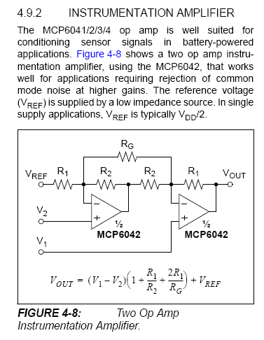

Guys I bought MCP6042 from stores.That's my final solution.I need some guidance building the 500 gain amplifier.Can it amplify at single stage?I read the data sheet but I couldn't find the maximum amplification.
Does it need to configure like a normal OP-Amp?
perhaps you can work under instrumentation amplifier mode Fig 4-8 in the combined datasheet
Hi sarma it has V1 & V2 but I have only one input.
