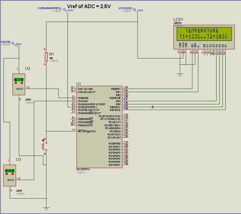

If you want to measure negative temperatures the LM74 is much easier to use. The LM35 will read negative temperatures, but you need a negative supply voltage if you want to read negative temperatures.
If you only want to read positive temperatures, and you don't need the best accuracy, you can just connect the output of the LM35 to and analogue input of the PIC16F877A.
1 degree change in temperature will give about 2 counts on ADRESH:ADRESL. The LM35 is analogue so the output goes up smoothly, not in steps.
The maximum output of the LM35 is 1.55 V so you can get more resolution if you connect Vref to a lower voltage. You can reduce it to 2.5 V (or 2 V if the supply voltage is less than 4.5 V) and that will give you more counts for each degree change of temperature.
If Vref is 2.5 V, 1 count is 2.5 / 1024 = 2.44 mV so you get just over 4 counts for 1 degree C.
The PIC16F877A has 8 Analogue input channels. You can only use one at a time but reading a channel takes much less than 1 ms so you can read one channel, change to the second channel, read the second channel, and so on.
hi, all
Thank you Diver300 alot again. I got it and i have finshed designing the program using the LM35 but the program still need calbiration. I will use the LM74 in future with 16f84.
