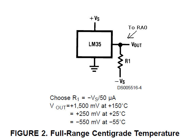

can someone help me in my project?...i am using a pic16f877 and lm35 with the output of 4x7 segment..i am using picbasic but it is not working well...so can someone help me..thanks

Post your program code..
What temperature range are you trying to cover? What is the Vref for the PIC's AD converter?
0 degree celcius to 150 degreee celcius with decimal point...sorry but i dont have a program yet..i just want a circuit and program that works in proteus..if you have can you tell me..if thats ok to you..
Let me try the question again. What voltage is the PIC powered from?
this is my program...the truth is i never learn to program using picbasic but i just in the internet and i dont know where is the error because when i use in proteus the display always 0000 nothing happen..can you help me fix this code..i use bc547 as decoder to commom cathode:
