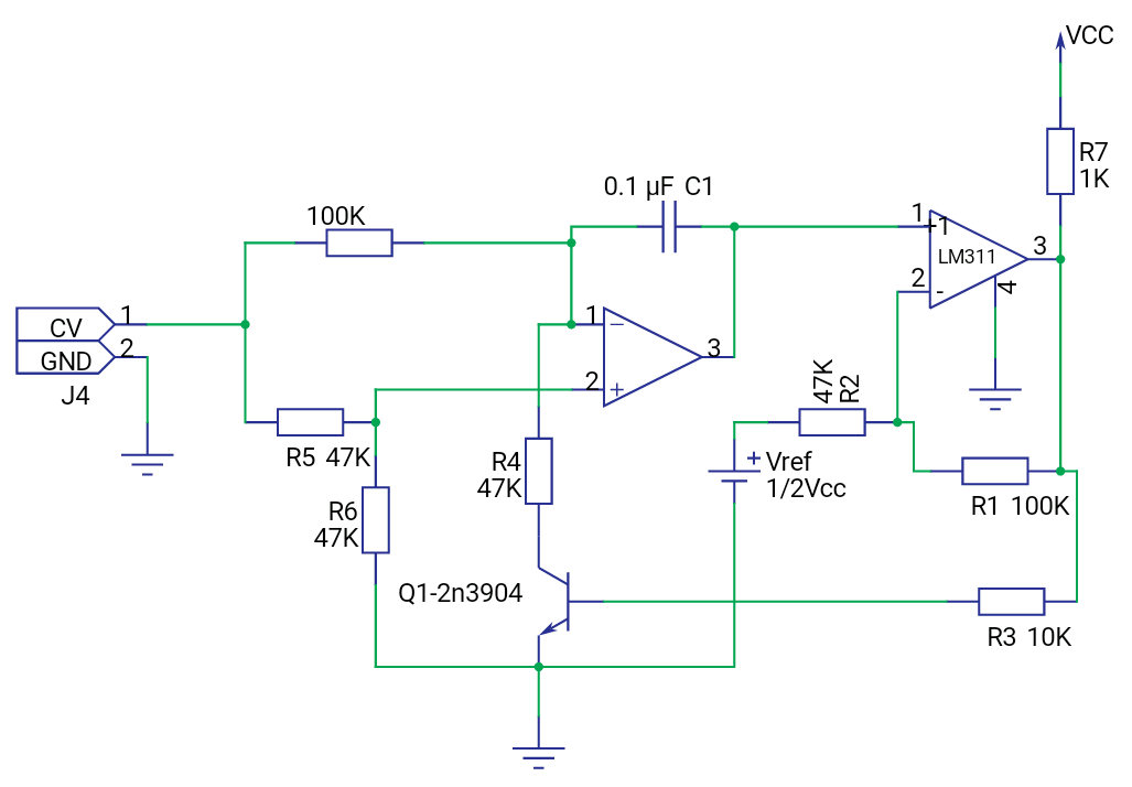

Another variation of the post #7 circuit. The Opamp can be quite slow like lm358 / lm741 In this circuit the Schmitt trigger is realized with a comparator, which is able to switch very quickly in comparison to an opamp. Another reason to use a real comparator instead of an opamp is that some opamps cannot be wired as comparator's due to input protection diodes.
Triangle output from the opamp. Square wave output from the output of the comparator (lm311)
The circuit also works well with the two half's of an ne5532 ( quite fast, GBW = 10Mhz )
The pin numbers are wrong!

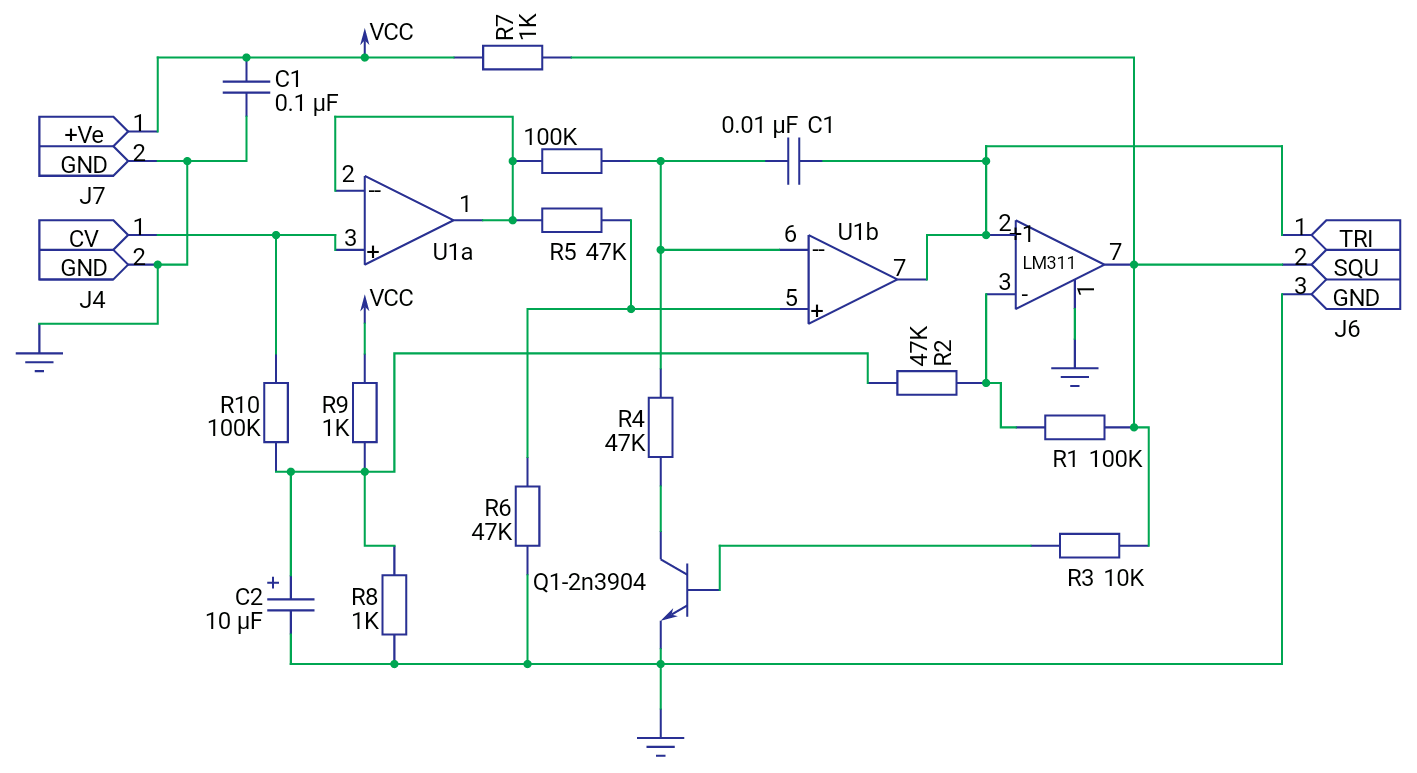

I have made a few additions to my suggested VCO circuit. Have used the other half of the '358 as an input buffer and have also added a potential divider to provide the 1/2 Vcc bias voltage.
I've also added the correct pin numbers on the IC's.
