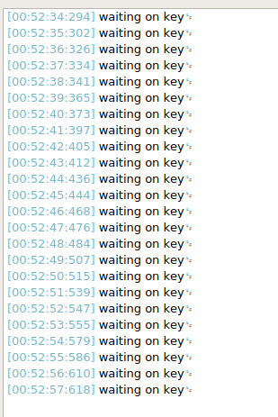

Little problem right here with a if else loop
be80be
Here the problem if I add the " else statement I get the waiting on key" but it doesn't go back and test the
"if (c != 0xFF) "
It never prints key press
If I leave out the else statement it prints key and **** pot of 0xFF

Yup. Computers are stupid. You have to tell it to do while your main program loop or use an empty while() in the last line of your program just so it won't run off into the memory wildneress after the last instruction trying to execute instructions, which it will glady do.
There is no loop. It will return from main and crash.
Yep it just sit's and tells me the no key press LOL so something like this is better

That still does the same thing.
the else is where it stays it does not look for key press

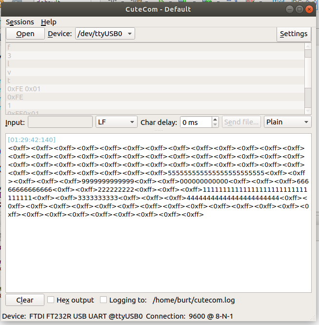

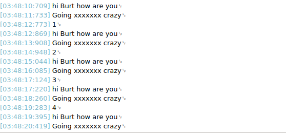

And what i get without the if else

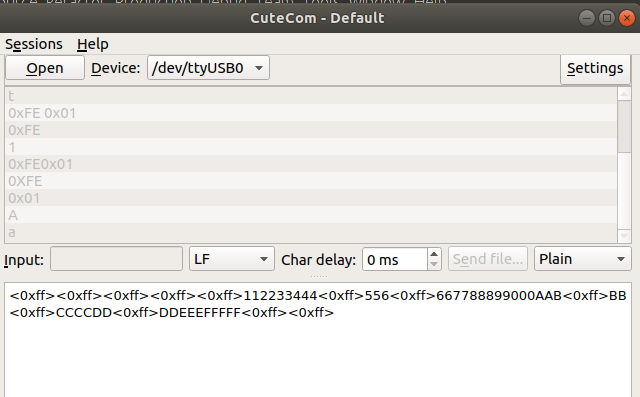

How do I get rid of the <0xff>
and get just a single press
It gets all the keys

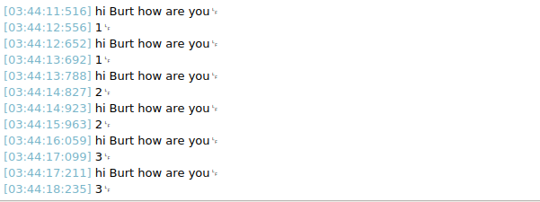

How on earth does anyone expect that code to work? It tests the variable c before placing a value in it.
Now I'm lost I think you mean this if (c != 0xFF)
c is loaded with 0xff if there is no keypress.
Look at this code,
 if (c != 0xFF) {
       c = ScanKeyMatrix();
            UART_Write(c);
        __delay_ms(100);
 else if (c == 0xFF)
You test c in the first line and load c in the second!!
And, you only load c if it isn't oxff!!! The code makes no sense.
C is loaded with whatever key is pressed if there is no keypressed it's 0xff
that's why I did the if not = 0xff
Dam your right I should be doing it like this ScanKeyMatrix()

It was loading the 0xff after the loop runs right.

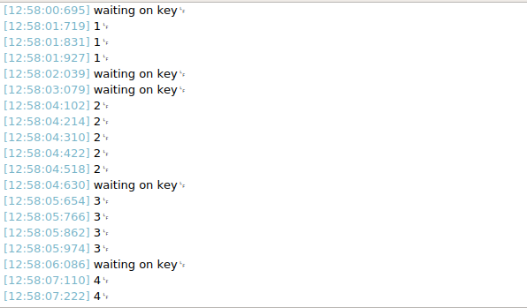

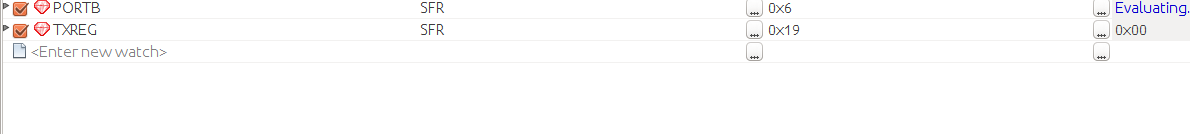

Well This is better now to get what i really want.

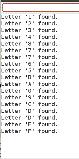

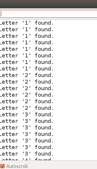

This get's the keys good now to figure how to stop it from printing more then one number.
 ScanKeyMatrixInit();
    char keys;
    while (1) {
     keys = ScanKeyMatrix();
       switch(keys)
    case '1':

    default:    //printf("Key not in list.\n");
    __delay_ms(100);
You need to detect rising or lowering edges. The way I do it is,
1. Get all keys into 1 variable - 16 bit for 4*4 keypad.
2. XOR with the previous value - this sets any key that changed to 1.
3. If active high - AND the XORed value with the current value - this gives a 1 for any new key press.
If active low then AND with the previous value.
4. Copy key value to previous.
For a single active low key on an arduino I use the following,
    pinMode(A0,INPUT_PULLUP);
    key=(digitalRead(A0));
    if((key^previous)&previous){
      Serial.print ("New Key press");
    Serial.println(key);
    previous=key;
Edit, added braces to avoid confusion.
