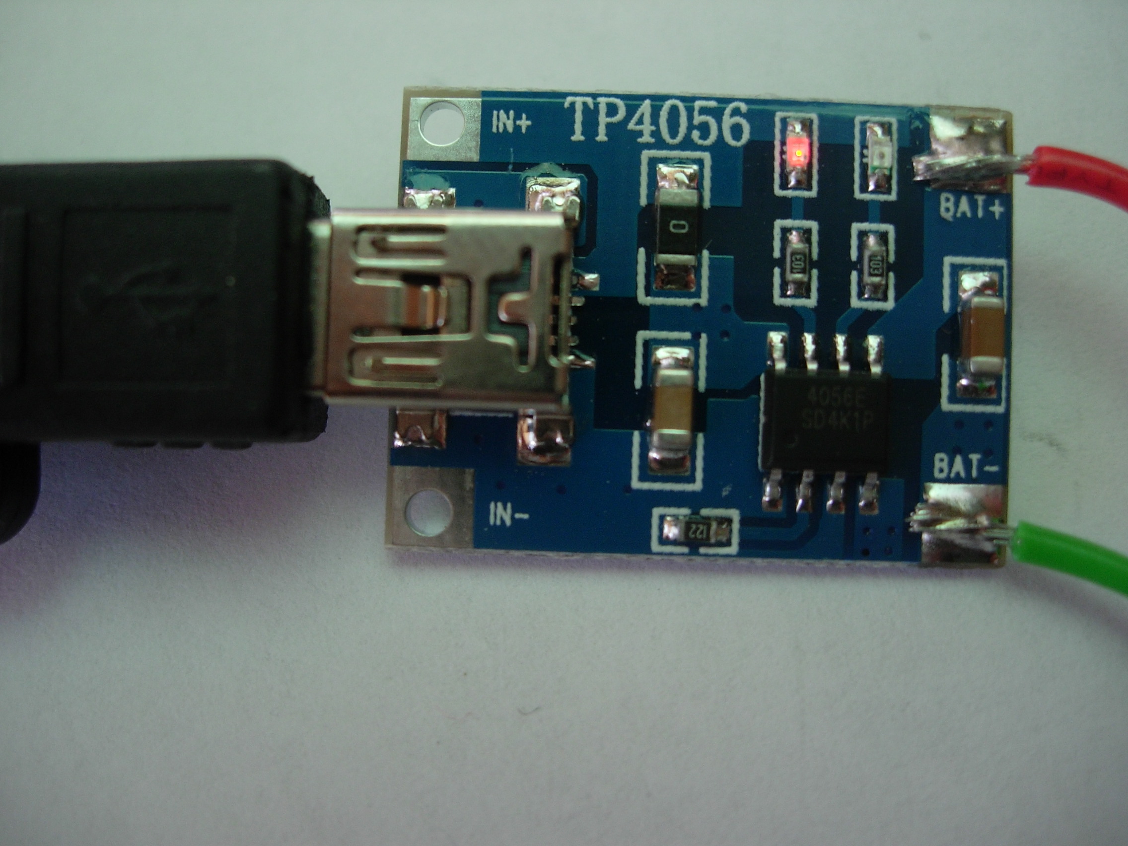

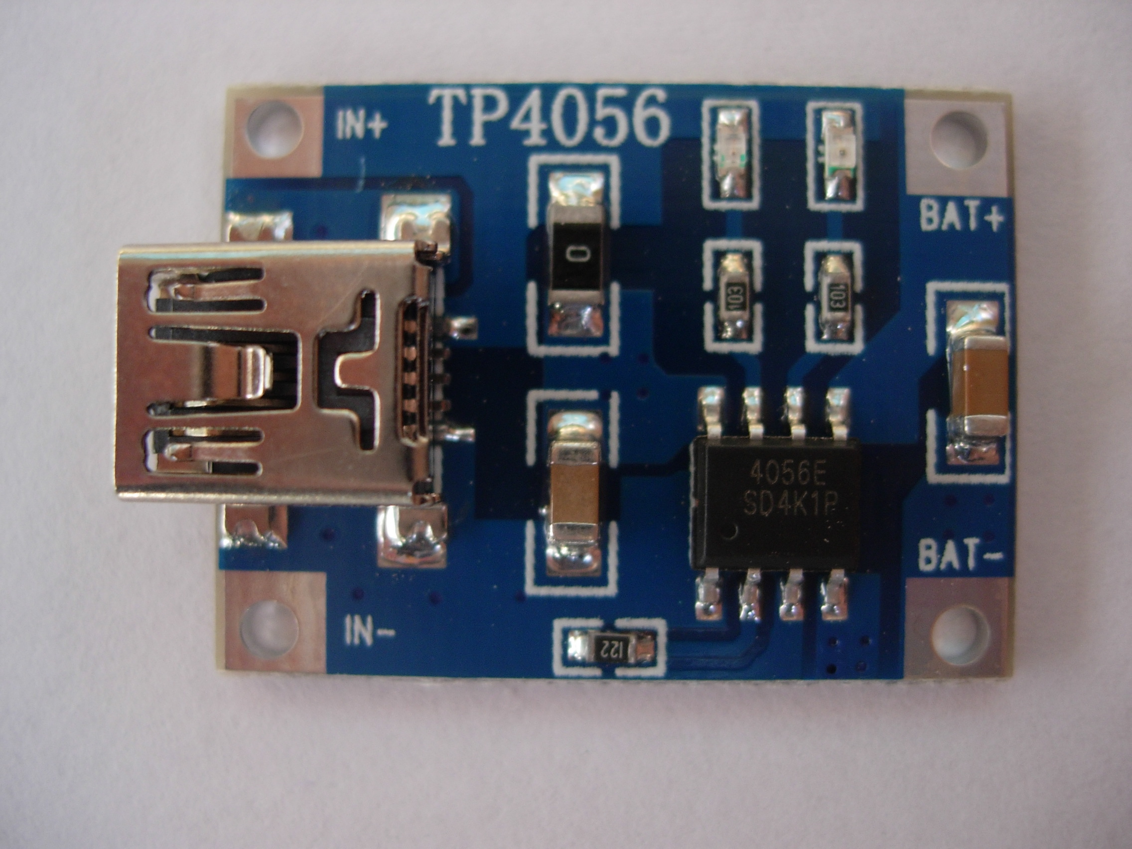

Thanks guys for your help. So what about this charger is it worthed for safety? Cause if it's good I buy this instead of building.
hash=item3609d67538:g:GIIAAOSw~uhUq6U-
Yes it is probably OK.
If it Doesn't work, Complain and PayPal will Refund your Money!
Ok Chemelec
As I read regarding the 18650 batts are not that sensitive as lithium polymer and can be charged without balancer.
Ok they should not over charged but if one regulates the voltage to certain hieght I don't think it will exceed that voltage.
You should always charge all LiIon batteries, LiIon and LiPo included, according to their individual requirements. LiIon batteries are very sensitive to charge and discharge voltages and, generally speaking, an accuracy of 50mV is recommended. This can be achieved by balancing or effectively providing a separate charger for each battery.
Here is a review of the charger you are considering: https://lygte-info.dk/review/Review Charger TP4056 UK.html
And for reference the TP4056 chip data sheet: https://dlnmh9ip6v2uc.cloudfront.net/datasheets/Prototyping/TP4056.pdf
spec
A Chinese charger sold on ebay with an unknown manufacturer? Do they have any quality control? Or are you guessing that it might not burn down your home? How cheap is too cheap?
I'll pass and buy a good charger from a local distributor that is made by a well known reliable company.

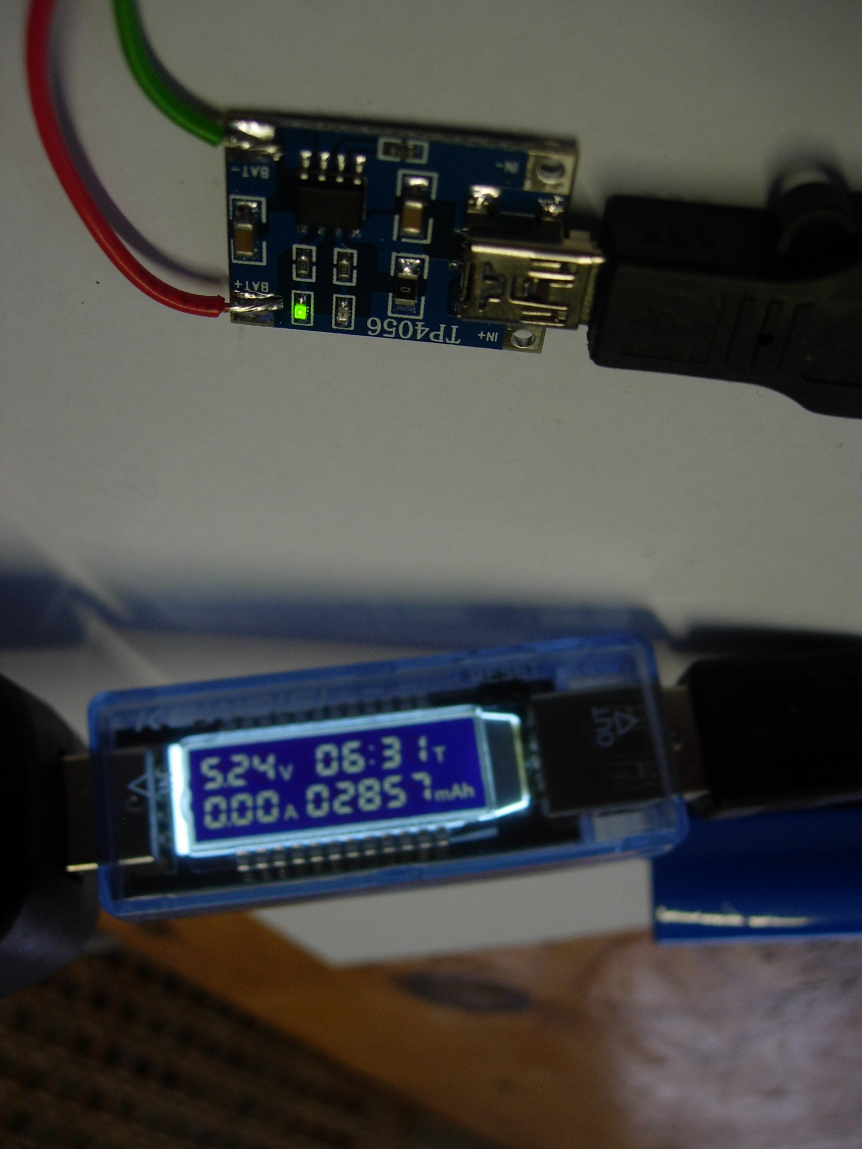

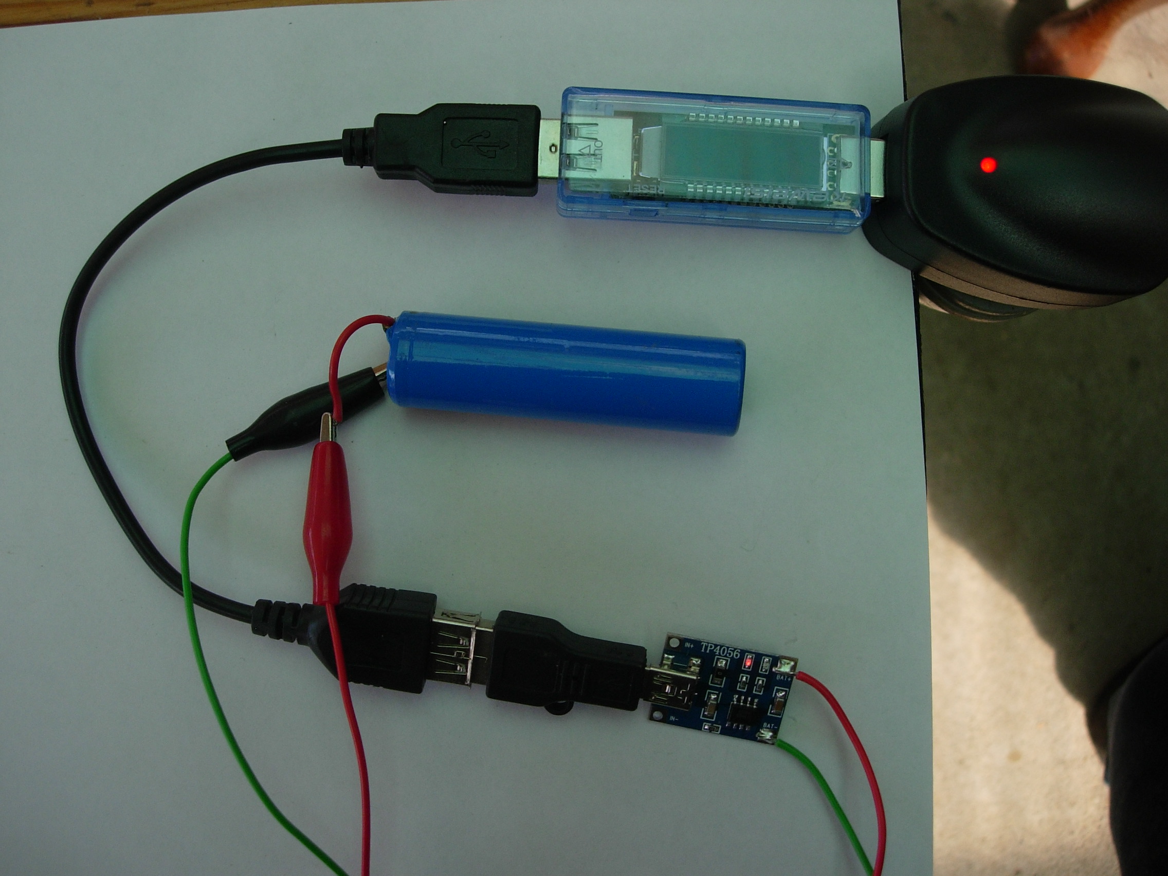

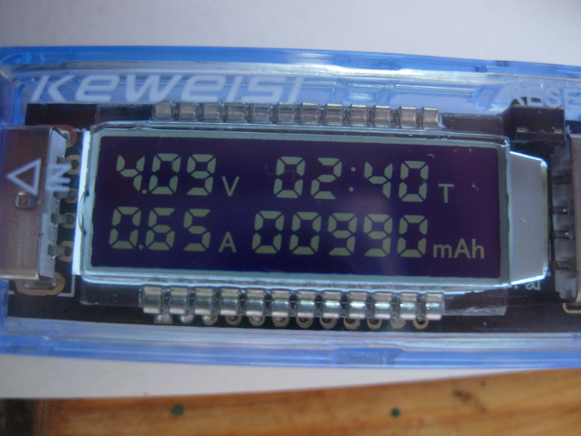

This is the module Andrew was refering to quite cheep on Ebay. I paid a whole lot more from a local electronics store $15. Set it up to day to see how it works & it appears to recharge a nearly flat cell. And yes its made in China as just about every thing else. The 4056 chip is quite cheep.
