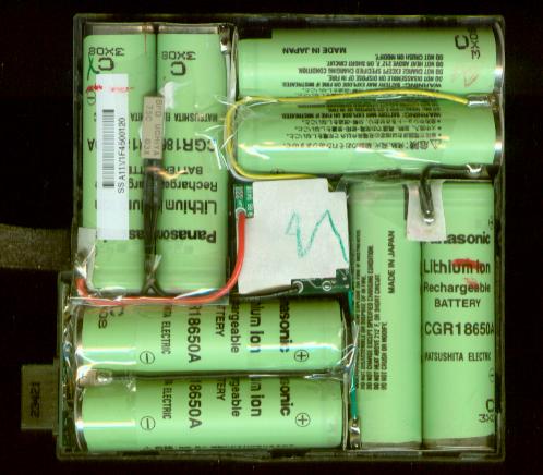

Hi John,
I removed the cover of my laptop and molested the battery pack
a little bit.
So what do you think ?
on1aag.
