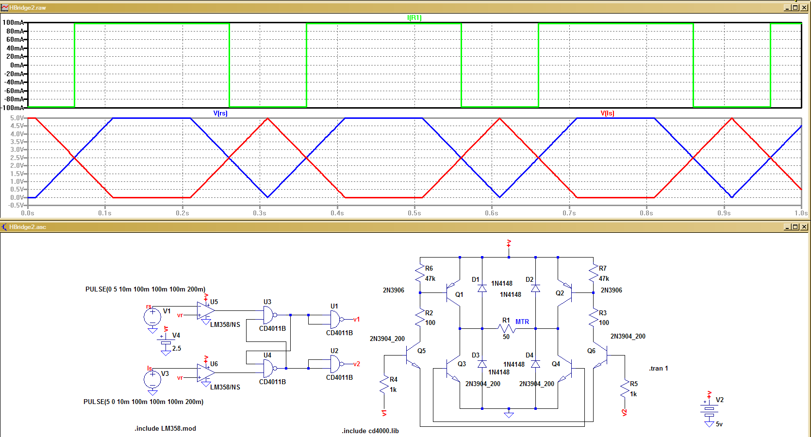

This project is a line follower. I have already the design but I'm not sure if this really works. I am having a hard time figuring out what values of components to use. To explain briefly this project, it is composed of a sensor and an H-bridge. The sensor transmitter/receiver will be from the sensor of a trackball mouse which is sort of an infrared sensor. By the way, the track or line that it would follow would be color BLACK. Whatever suggestions/changes for the design you have would be a great help.

hi m80,
Looks OK, runs in Simulation, look at this image.
I have added R6 and R7
