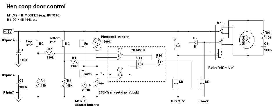

This would be my approach :-
The light sensor is a simple photo-resistor and should be protected from rain/dust to avoid problems KISS pointed out.
The relay would need a 12V coil and contacts rated for DC switching of an inductive load at > max current of the wiper motor, although in this design power is actually switched by MOSFET M2 rather than the relay contacts.
Standby current (motor off) is only ~ 0.5mA.
Push buttons enable manual over-ride for up and down.

You did well to get an astro timer for $15. The ones that showed up in a google search were anything up to ~$300 !
  • CoopDoorControl.asc
Alec - thanks for the wiring diagram.
Will give the diodes a bash first then worry about the power consumption - like the idea of the MOSFET.
