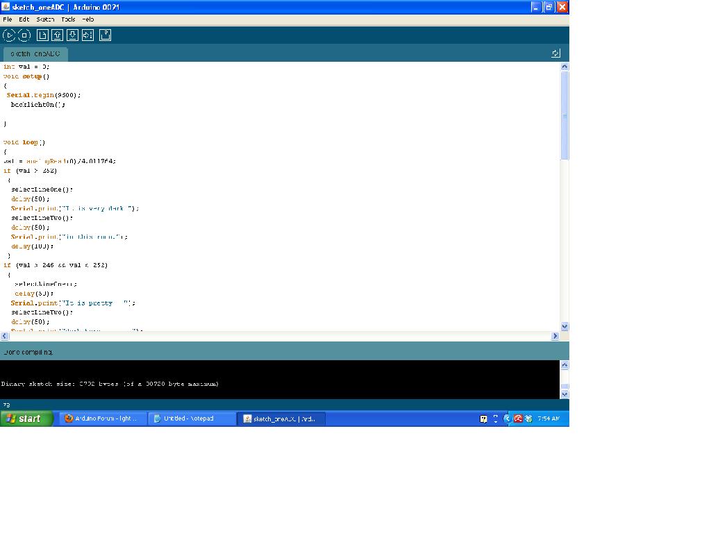

be80be THANKS so much for the help and the quick response!!! I appreciate it so much!
Now that I have the original code and now the serial.begin code, would I just have to combine the two for it to work OR does that original code work with how it was shown as is with the serial.begin?
Will just typing in serial.begin be recognized by my arduino board? Once again thanks be80be!!!
Here you have the compiler installed if so you can try this out I'm posting the whole thing done compiled in the zip
I posted a pic showing the compiler window Maybe this he will help

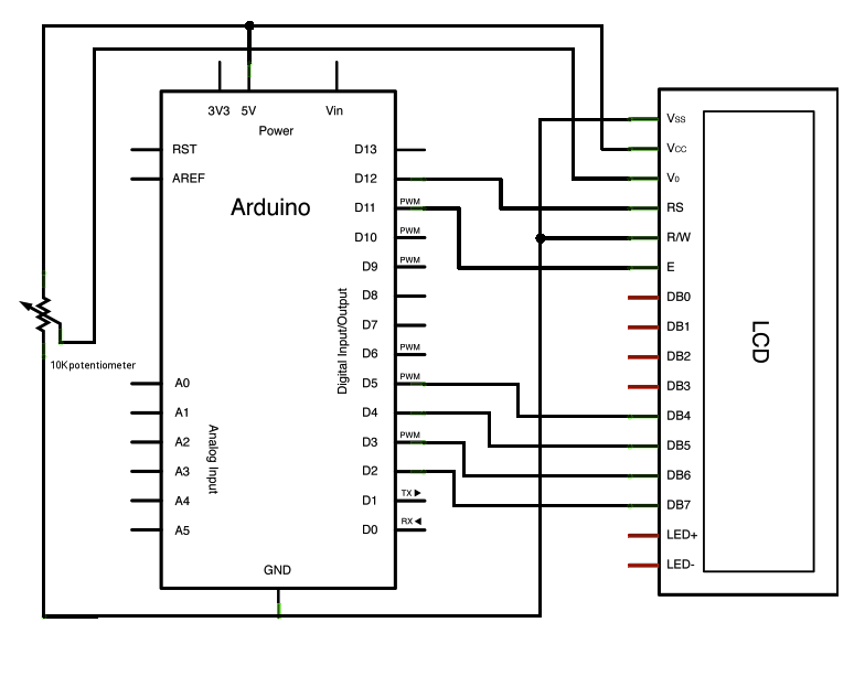

I tried resetting the board and uploading the code many times. I also uploaded the “Hello World” code in between testing and that would work perfectly every time. So the possible 2 issues I think I’m having are that I do not know the type of photocell the person used or how exactly he hooked up the photocell. Even if I didn’t know his exact photocell he used I’m thinking I should still be able to see a light condition being displayed on my lcd even if it’s a wrong light condition.
I also found this code (**broken link removed**) which looks to be the best and the exact code I would need for my application but it also just makes the LCD screen go blank for some reason. Can anyone please help me out? I would so greatly appreciate it. THANK YOU SO MUCH!
Post what board your using and what chip it has on it and I can help you
Thanks Be80be! You're the man!
Here is the board I'm using:
Arduino Uno - SparkFun Electronics
Here is the LCD screen I'm using:
https://www.sparkfun.com/products/709
I've been doing some more research and I read something about how maybe the lux code I found will work but its just that the code doesn't recognize which LCD screen I'm using. So I was thinking the code needs to be edited to the LCD screen I'm using. Remember I'm a newbe to all this so I'm not sure how true that could be but it seems like it makes sense.
First off are you sure you have the LCD hooked up right try this when you get working you can then go on and use the LDR.
Thanks be80be for trying to help. That's exactly what I used was the "Hello World" example from the Arduino website. It worked perfectly displaying hello world and the time. I just need to figure out how the light sensing code is going to work on it. It just displays a blank screen when I use the lux code I found.
So that works right So you no your hardware is ok. The code posted for adc is using a serial LCD I think

Yes I would say the hardware is all set. So I beleive its probably the code or even maybe how the photocell is hooked up. I'm thinking its most likely the code. What do you mean by "The code posted for adc is using a serial LCD"? I'm sorry but what is adc? Thanks.
Leave your LCD hooked up as is and try the code I posted last nite this code

Hey Guys,
Just letting you know that I got the light meter up and working. I just wanted to thank everyone (especially be80be) for all the great help I received here. THANK YOU SO MUCH!
int photocellPin0 = 0; // the cell and 10K pulldown are connected to a0
int photocellReading0; // the analog reading from the analog resistor divider
float Res0=10.0; // Resistance in the circuit of sensor 0 (KOhms)
// depending of the Resistance used, you could measure better at dark or at bright conditions.
// you could use a double circuit (using other LDR connected to analog pin 1) to have fun testing the sensors.
// Change the value of Res0 depending of what you use in the circuit
// include the library code:
#include <LiquidCrystal.h>
// initialize the library with the numbers of the interface pins
LiquidCrystal lcd(12, 11, 5, 4, 3, 2);
int val = 0;
void setup()
// set up the LCD's number of columns and rows:
lcd.begin(16,1);
void loop(void) {
photocellReading0 = analogRead(photocellPin0); // Read the analogue pin
float Vout0=photocellReading0*0.0048828125; // calculate the voltage
int lux0=104.1*Vout0; // calculate the Lux
// Print the measurement (in Lux units) in the screen
lcd.print(" Lux\t");
lcd.print(lux0); // Print the measured level at pin 0
delay(100);
// turn off automatic scrolling
lcd.noAutoscroll();
