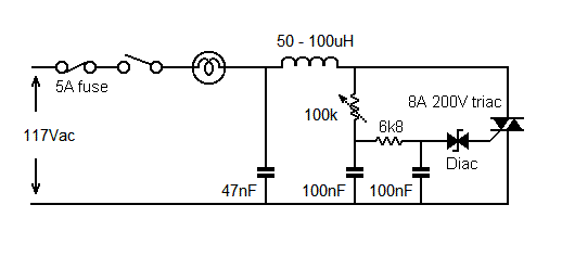

Lots of schematics and designs available on the web but some things you need to consider -
What kind of light? Incandescant, fluorescent, HID are some kinds. Some can be dimmed, some can't - for those that can the dimmers are significantly different.
How much power/current?
Continuously variable? What kind of turndown (how low do you want to go) is desired.

look up Phase angel control.
its a way of controling the brightness of the light by changing how muchof the AC cycle its on for. (like flashing it very quickly)
you'll need to use a TRIAC, there fairly simple, but the posibilitys are endless.

sammy004 said:
Can anyone help me out on building a real simple 120volt light dimmer
This can be used to control the brightness of a bulb or the speed of a small motor.

sammy004 said:
I also found this on the net https://www.aaroncake.net/circuits/dimmer.htm
but do I have to use a neon lamp for L2 or can I just leave it or use something else also that is a 40502 triac what exactly is the rating of that piece.
That circuit is effectively the same as David posted, except it uses a neon instead of a diac, and doesn't include supression components - you really need to include them, dimmers are VERY noisey things.
Any mains suitable triac of sufficient current rating would be fine.
What are supression components and where do I add it in the circuit. also does my diac need to be a specific rating.
The choke and the 47nF are the suppression components in David's circuit, diac's are generally fairly standard, intended mainly for this exact purpose - triggering a tric or SCR.
could some one explain what a diac is please.
and what there used for?
from the circuit above i can see its used to trigger the TRIAC, why?
