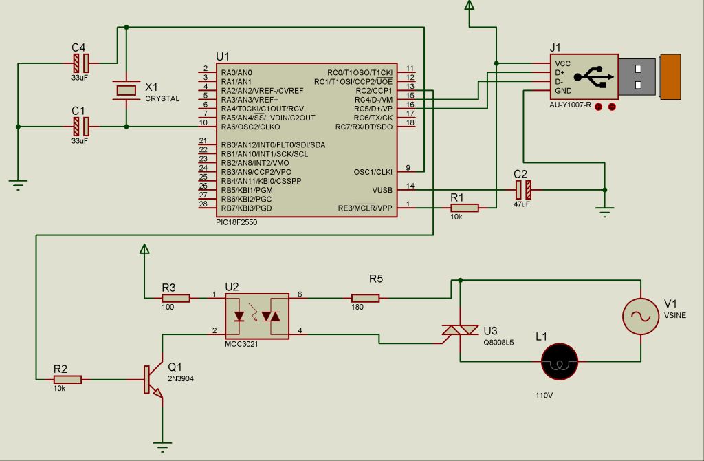

Hello,
I'm trying to control the light of a bulb with PWM. I'm using a PIC 18f2550 since i have to send information to the computer through USB and receive the set point from it.
As optocoupler, I have a MOC3021 that is coneccting the control circuit with the power circuit. In the power circuit I use a Triac BT136.
As I change the duty cycle of the PWM, It is supposed to change the intensity of the light, but it doesn't work. The PWM is working alright. I guess the problem is something with the power circuit or with the optocoupler.
I would like you help me to determine where the problem is.
Thanks for your help.

You are sure you don't have the MT1 & MT2 terminals reversed?

I am really very bad at this kind of circuit, but I can see that firing the triac depends on having the "on" signal from the PIC synchronous with the sine generator and have variable time lag compared to the zero crossing point. How does the PIC know the phase of the sine generator? Without that information, the MOC firing signal from the PIC will have random phase information.

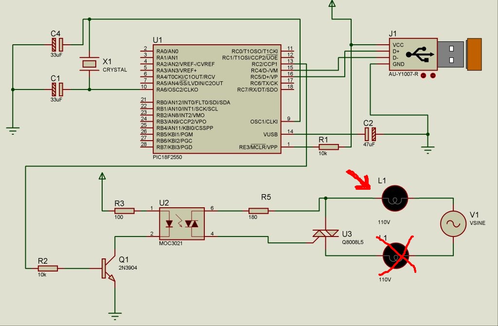

Ron was right. The light buld goes on the other side of the triac, sharing a connection with R5. Also, what is your PWM frequency ?

True, the light bulb was on the wrong side of the triac. I'd still like to know how the PIC finds the phase information.
No, you don't want PWM, you want phase control .
I think you're confusing the two.
PWM with mains is normally done at a lower frequency than the mains frequency and is suited to heaters but not lamps which will flash because the frequency is so low.
The algorithm for phase control goes like this:
Wait until the mains voltage is near zero (typically below 15V or so), start a timer.
When the timer finishes, fire the TRIAC.
Go back to the start.
The duration of the timer controls the brightness. The maximum duration is half the period of the mains frequency, in other words, t = 1/(2f). The longer the duration of the delay,, the later the firing, the dimmer the bulb will be, the shorter the brighter the bulb will be, if there is no delay and the TRAIC is fired immediately, you get full power.
A comparator is normally used for zero crossing, the AC voltage from a transformer (which is also normally used to power the rest of the circuit) is compared to the 0V rail, when the comparator is high or low (depending on which way round the inputs are connected) AC signal is 0V.
You need a small mains transformer so you can monitor the mains voltage. An opto-coupler also might work, connect the LED to the mains, with a reverse voltage protection diode in parallel, via a suitable series resistor and connect the photo transistor to an MCU input using a suitable pull-down/up resistor. The LED will only be activated when the AC voltage is above about +1.5V, this will turn the photo transistor on, letting the MCU know that the AC voltage has just passed through 0V, when the voltage drops below about 1.5V, the LED and photo transistor will turn off, letting the MCU know again that the AC voltage is near 0V. You can use either the on, off signals, or both, to start your timing delay, you only need to use one because you know that the mains will be near 0V again after 1/(2f).
