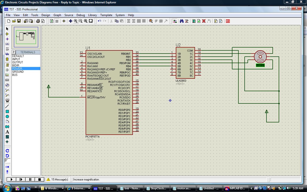

the program when i built it on Mplab it says zero errors.I used ISIS 7 Professional to construct circuit diagram and when i run it, the motor do not rotate the way i want it to rotate, it rotates one step about 30 degrees and it stops, but i want it to rotate continuously until i stop it
circuit.jpg The circiut diagram looks like this. can u try it and upload my code and see if it will work
:)i have figured the problem, the delay subroutine was not correct. now that i have corrected the delay subroutine at lest it can turn 180 degrees clockwise

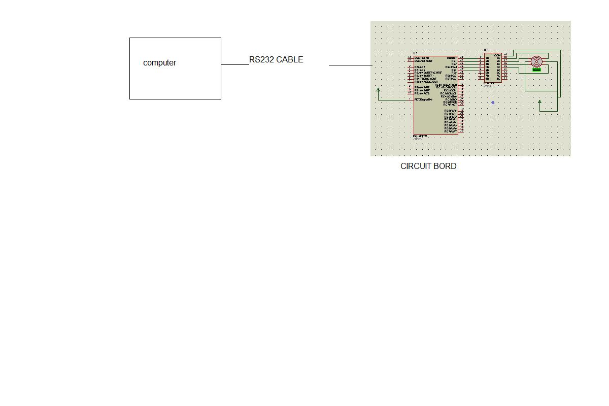

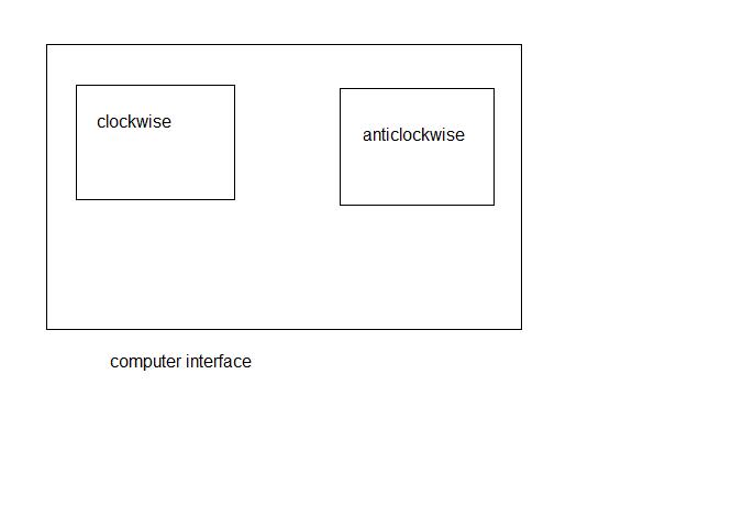

birdman0 i want to make a simple comuter interface which looks like that one on the picture. if i click the box (clockwise) then the motor must rotate clockwise or if i click anticlockwise then the motor must rotate anticlockwise. im not sure which programing software i must use between visual studio C++ or axampp to make such interface. i have read about USART and how to send data through rs232 cable.i think these two diagrams can easily explain to you what im trying to say. i want to control the motor on the circuit board using computer where by connection between the computer and the circuit board is made by rs232 serail cable
