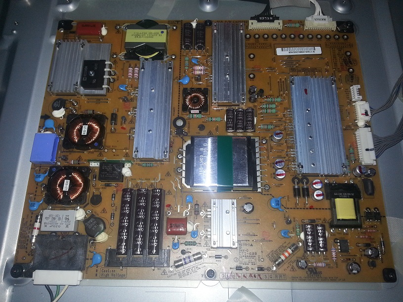

Most likely you have some bad capacitors. A photo of your supply board may help us determine which capacitors are the most likely to have gone bad.

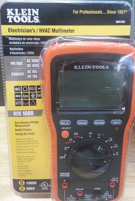

would this be ok to check the caps.
You need to use an ESR meter and preferably one which allows in circuit testing (they limit the test voltage). While many capacitors bulge or leak when they start to fail, others will show no outward sign of damage.
You pasted a page URL in image tags. For those wondering, this is what he is referring to: **broken link removed**
hobbyguy , most likely no. Multimeters sometimes measure capacitance, but I have never seen one that measures ESR. You really should buy a dedicated ESR meter, or just replace the entire power board (or all the caps on it). I'm still waiting to see a photo of your power supply board....

Oh, sorry ill open it up rite now and post some pics of the power supply board.
Ok im gonna have to wait till I go to work I dont have a computer to upload the pics and on my phone is not letting me one picture the system is telling me is too large and I converted it to pdf but nothing happens after I choose it to upload the file.
Ok, I was able to re-size the image of the power board let me know if thats ok or if is to small.
The other images are from the meter i was telling you guy if you could see the back side of the meter it say that you could test capacitor, but not sure if is good if you could take a look and let me know if that would be a good decent meter. would you guys let me know of a good site with free shipping to buy and ESR meter

As I mentioned before, some multimeters measure capacitance, but that is not the same as ESR. In order to measure ESR you'll need a dedicated ESR meter (that's what they're actually called--try googling it). The meter in the picture will not help you.

I didn't say anything yet in regards to your photo of the power board. That was just for reference, so that we know how your particular power board is set up. I said that the meter you posted a picture of won't help, so yes--do google "ESR Meter".

Sorry about that. I meant the picture of the meter :p
