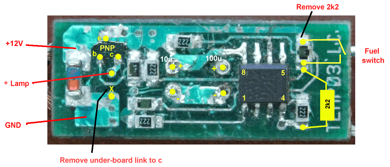

I do have the old IC and the dimple for pin 1 was in the top right corner as my photo is oriented. My electronics trouble shooting skills are limited but I've been building boards since I was a little kid for my father who was as electronics engineer so am well aware of how to connect components and IC's, that's why it's bizarre to me that the polarity and IC may be reversed.
However, this sensor has never worked since I've had the bike since 2011 and I can't confirm if it ever worked. And having owned several Lancias in my life I know how bad Italian automotive electrical systems can be, maybe the circuit was built wrong in the factory and it never worked.
So, shall I reverse the LM393 and the supply polarity and give that a go ?
I reversed the supply polarity and the LM393 and the low fuel light is still permanently on.
There is 12V going in and 9.5V coming out to the lamp regardless of switch state. Any ideas or things for me to check ?

Well that's points 1 and 2 taken care of. I suggest you next try 3-6, which hopefully will cure the lamp-stays-on problem.
I find it's easy to get confused with IC pin numbering and orientation when turning a board over to check top and bottom sides; a mental flip of the IC is needed.

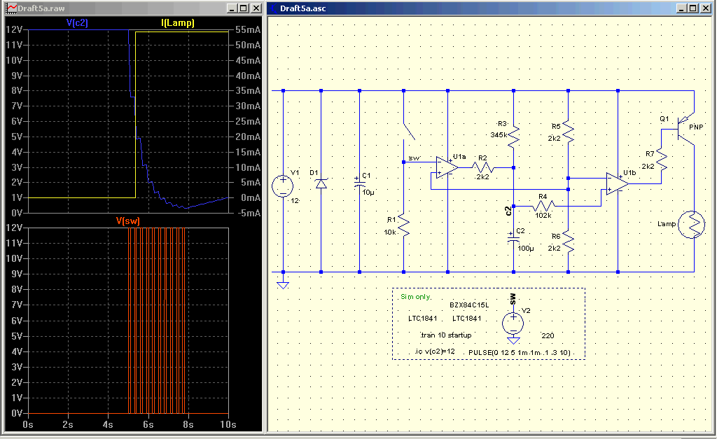

Right. Here's what I think the circuit was intended to be:

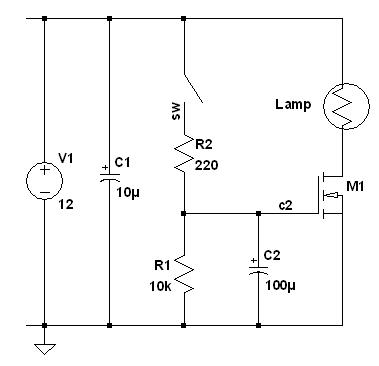

In my view a much simpler circuit (not much more than 1xR, 1xC, 1x MOSFET) would have done the same job more cheaply :)
Edit:
Here's the cheapo version
Alec, I'm not sure this thing ever worked or ever will work, so I'd like to give your cheapo circuit a try. I don't suppose you could provide a component list could you ?

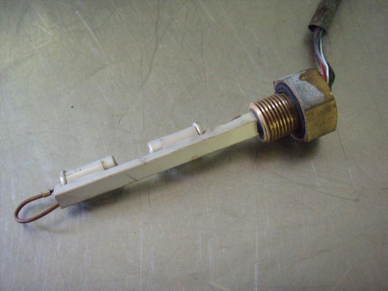

Or I may have a better transducer that doesn't (apparently) need a circuit:
I believe it's using thermistors and I just connect this in series with the lamp. There are two thermistors, when the fist thermistor heats up due to not being immersed in fuel, the fuel lamp flashes. When the second thermistor warms the lamp goes solid. I would just connect one of them.
What do you think ?

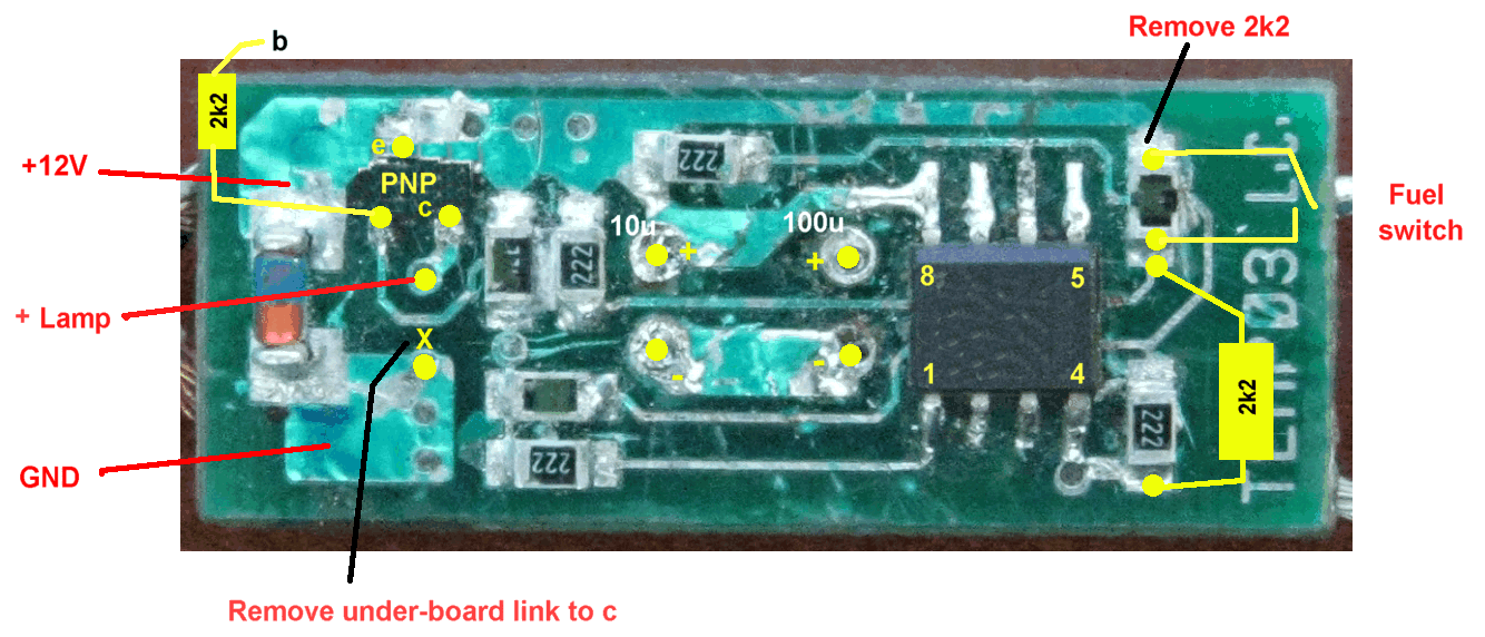

We should be able to get your board working. Here's the revised version:
Note that +12V is now at the top, Gnd (0V) is at the bottom, the PNP has been rotated (assuming the pin-out was correct in your photo) so that the emitter goes to the top rail, the circuit track under the board beneath the 'X' needs cutting to isolate the collector from Gnd, the lamp connects between collector and ground, the caps have + at the top and - at the bottom, the IC is oriented with pin 1 bottom left, the 2k2 near top-right is removed but a 2k2 (same one) is connected between IC pin2 and ground, the fuel switch connects between pin 2 and +12V. We'll keep the cheapo version as 'plan B' :)
According to your post #1 the 2FZ is a PNP. That's what's needed.

Well if you want to try the board mod in post #26 the transistor needs to be PNP, e.g. a 2N2907 or a 2N2905A. May help wiring-up if it's not a surface-mount type. BTW, in that mod I forgot the base resistor. Apologies. Here's a corrected version:
I think the diode is a zener for limiting the voltage across the IC in the presence of transients, the blue band denoting the cathode. But from your measurements it seems fried (a zener should be relatively low resistance in one direction). I suggest replacing it with a 15V zener or a suitably-rated varistor.
If the capacitors have been subjected to reverse voltage they may have failed. Do you have spares?
I hate to be a pain Alec, but could it be reworked using the NPN transistor and more like as intended ?
I'll have a think and get back to you.
Edit:
1) Does the level sensor switch have both normally-open and normally-closed contacts?
2) Does the lamp holder have a permanently-grounded connection or can it be disconnected from ground (e.g. has a pull-off connector)?
