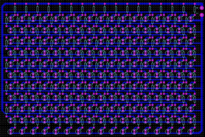

Thank you for all the replies guys! Is there a schematic which I can refer to if I want to construct a 6 x 4 rows of blue or white leds?
Cheers!
Attached is a circuit I made for my UV box... it's a bit bigger than you need but it will give you an idea of how to do it.
Thank you! What's the value of the resistor that you are using? My supply is 12V from a car.
Cheers!
That will depend on the fwd V and rated ma of the LED's you are going to use. Once you decided on the LED's let us know what they are, and we will assist in working out the value of the resistors.
The LED's I used was reated 3.3V and 20ma, so I used 430R resistors on a 12V power supply.
Why didn't you use two LEDs connected in series?
You could've halved the power consumption, the number of resistors and made it easier to assemble.
Because I read about some problems using them in series... assembly was easy enough and I have a 13A 12V psu lying around doing nothing.

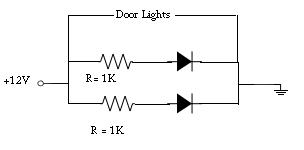

Please take a look of my plans, please comment if there is any problem with it.
Cheers!
I dont see a problem with it. You might be able to go for lower value resistors if you want them brighter (depending on the max specs of your LED's).
