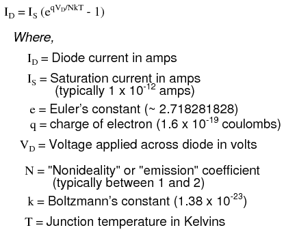

Forward Voltage drop.
I've been trying to get a handle on the expression.
What's it mean by forward?
What is meant by drop?
What if there's more than one LED in the string running off one resistor?
If an LED is rated at 2 volts and there are 6 of them in a parallel the "Forward Voltage Drop" across the 6 LEDs is a constant at the 2 volt factory rating of the LED. REALLY? This can't be. IT has to be some cumulative number subsequent to the drop across all the LEDs in any given parallel string.
I think that it is the voltage delta between anode and cathode of the LED that arises when a current is passed across it.
This means that there is a physical gap in the LED across which voltage must pass. In bridging the gap some voltage is lost (the fairies take it?) and that is the drop.
I found this the forum won't let me use sub and super script
ID = IS (eqVD/NkT -1)
Where
ID is the Diode Current in amps ( my case 15mA - 20mA)
IS Saturation current in Amps (1*10-12 amps)
e = 2.718281828 (Eueler’s constant)
q = the electron charge (1.6*10-19 coulombs)
VD = voltage across the LED in volts
N = non ideality or emission coefficient (a number between 1 & 2)
K = 1.38 * 10-23 (Boltzmann’s constant)
T = junction temp in Kelvin
Here is the JPEG image with the correct script
The formula is more like Greek to me than Greek was in College.
If all I wanted to do was drive a few LEDs I'd lust start wiring and playing with resistors but I want a series of parallel strings of LEDs with totals in the hundreds. I'm looking to build a light source.
arrrgggghhh
