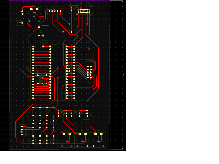

I'm designing a 18F8722 Controller board, and with that many pins means I need lots of LEDs on it (obviously). I want to put a LED on the MCLR pin so it indicates when the board is being programmed or there is activity on the MCLR pin. Currently I have just the 10K Pullup and a switch that when pressed connects MCLR to ground. However, how do I add an LED to the circuit? Would I sink or Source the LED via the MCLR pin?
RG5/MCLR can only be an input. As it needs a pull-up in many configurations, I would put an LED (with a suitable series resistor) in parallel with the pull up.

Just use female headers then plug in your LEDs as needed.
Not sure pin count of 8722 but design board as needed.
