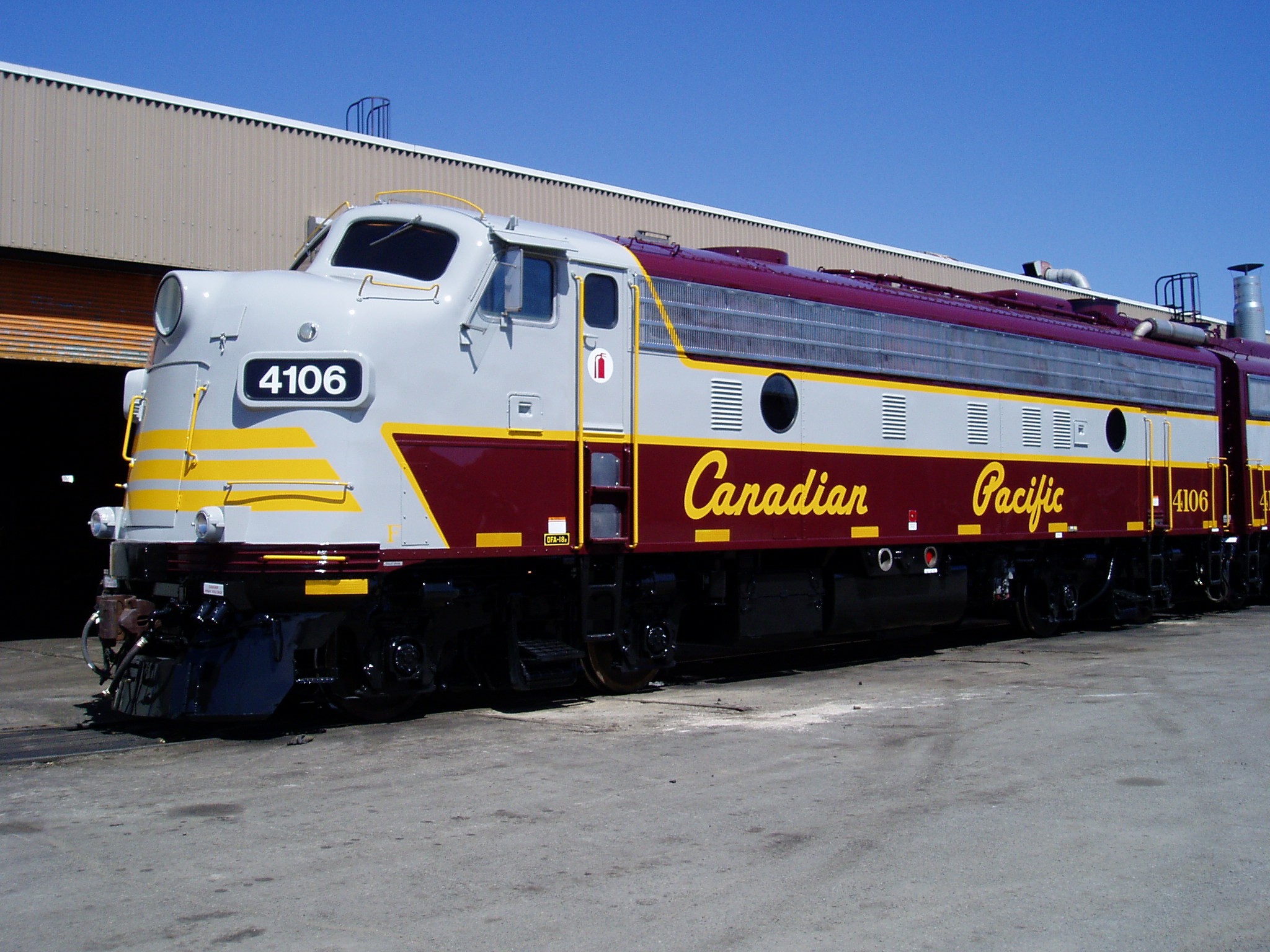

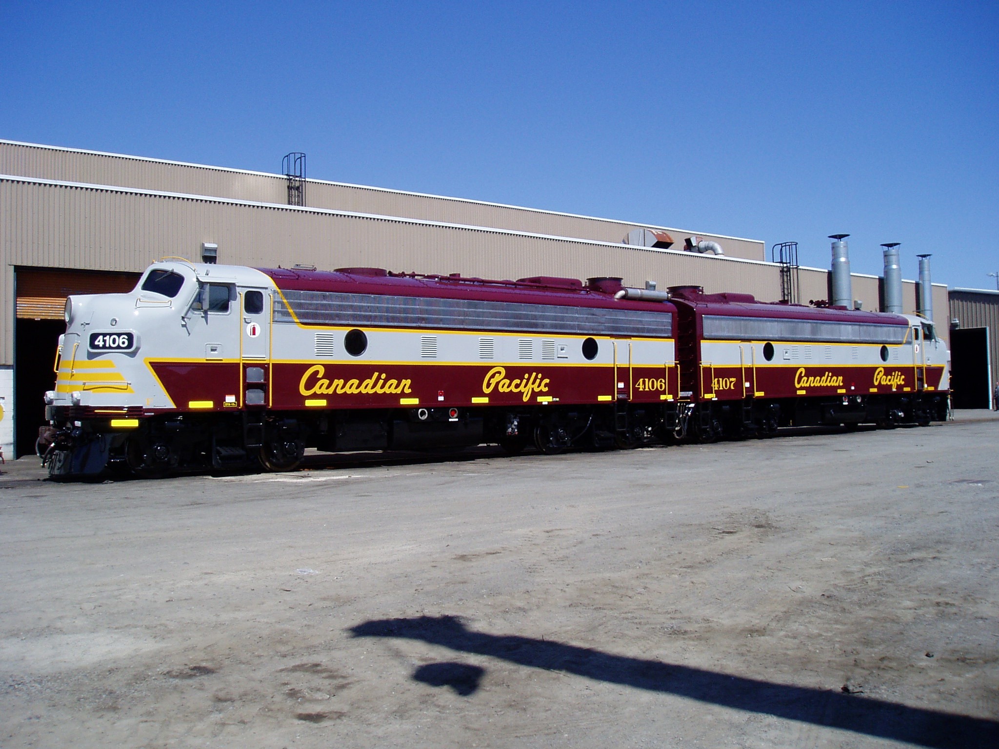

These old retro's we upgraded to dynamic braking for use in the Rockies, they had 8 battery's at 8vdc.

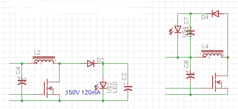

If you need to run lots of LEDs to get 20 W, you could put them all in series and go to 150 V or more with a boost regulator. Most boost regulators can't produce less voltage than the supply, so you will normally need to have more LED voltage than the maximum supply voltage.
The input current of a boost regulator doesn't have the fast current changes that a buck regulator has, so there is less need for an input capacitor. An output capacitor will reduce current variation in the LEDs, but if you are switching at 100 kHz or more, you won't need a big capacitor and no-one will be able to see flicker at those frequencies.

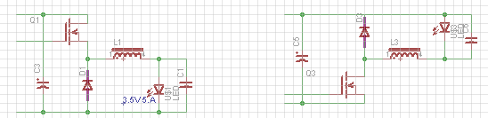

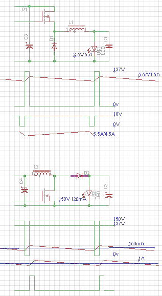

Top half, buck, 3.5V 5A LED. FET turns on at 4.5A and off at 5.5A.
At high line, FET is on for a very short time. FET current is 5.5A pk. L1 is high inductance so LED current is continuous. C1 can be 0uF.
At low line, FET is on for most of the time. FET current is 5.5A pk.
Bottom half, boost, LED=150V 120mA,
At high line the FET is on for a short time. Peak FET current is 150mA.
At low line the FET is on most of the time. Peak FET current is 1A. D2 current is 1A pk to get 150mA average.
C2 must be there because D2 current drops to zero.
These two are the same thing. I have used both.
This an interesting alternative. On the right side the LED voltage and the input voltage have less restrictions. An 50V LED will work.
The one on the right is a buck/boost regulator, which will have discontinuous current in the supply, although there will be smoothing with C8. A boost regulator, as shown on the left, has the inductor in series with the supply so the supply current changes less. The downside is that the LED voltage has to be larger than the maximum supply voltage.
