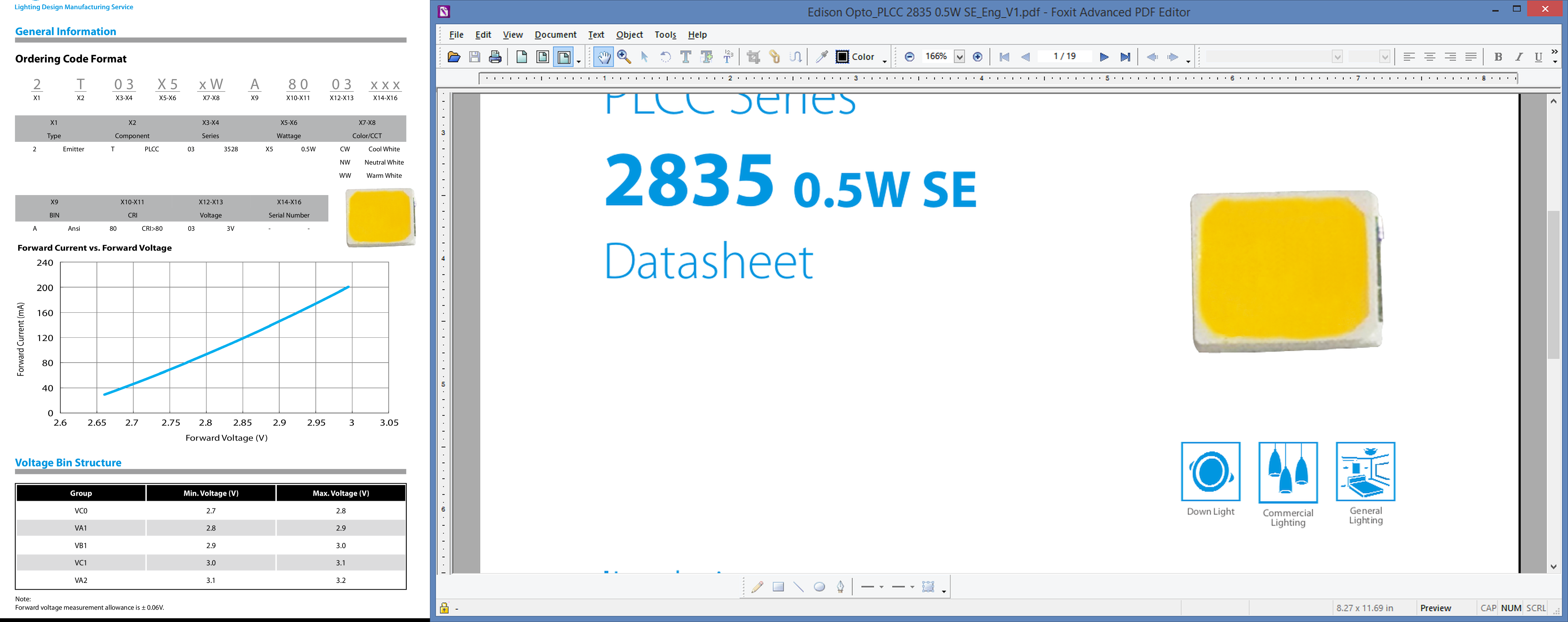

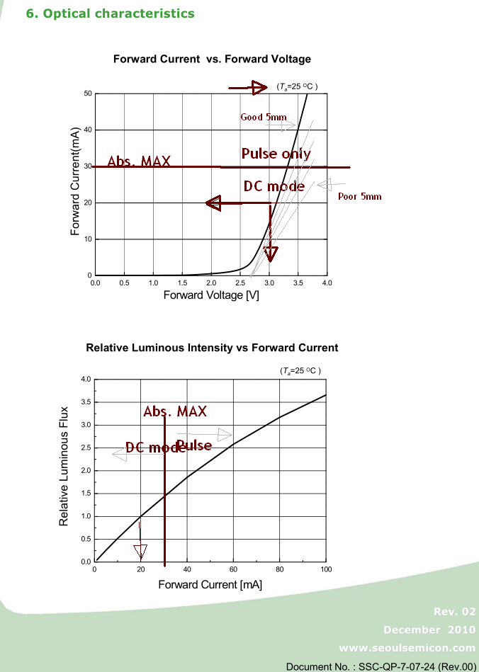

Here are two LEDs 65 mW in 5 mm TH then 28x35 mm in SMD 500mW
Note the slope of VI is the ESR is inverse to Pd rating of package and thus Vf forward voltage can be predicted.
Zeners use Zzt for impedance of Zener Threshold instead of ESR and they have a wide tolerance just like LED's ( typ 25% ( which thus affects the rated Forward Voltage Vf at some rated current for DC operation..)
Thermal effects cause the Vf to reduce as well by about -4mV/'C
So ESR drops from 2.25 Ohms to 1.50 Ohms in this 500mW WHITE LED, It is a great LED due to low ESR and high brightness
That is from current rising from 30 mA to 200 mA or 600mW ( which would need a really good SMD heatsink)

Epoxy 5mm LEDs get hot inside so dont bundle them close together and drive them at 30mA and expect them to last 50kh.. They wont.
This is about 10% of the ESR in a 5mm LED which is approx 15 Ohms at 20mA
