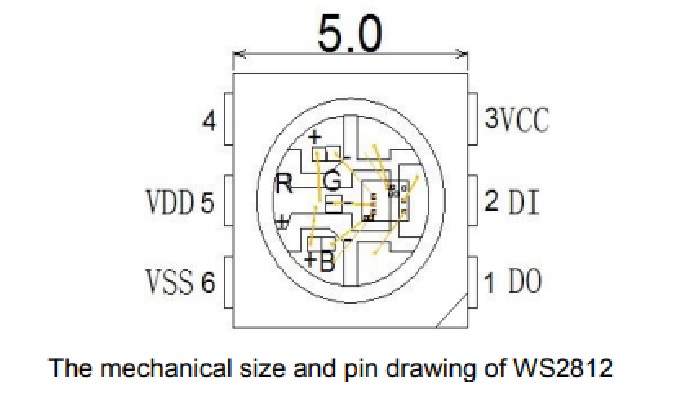

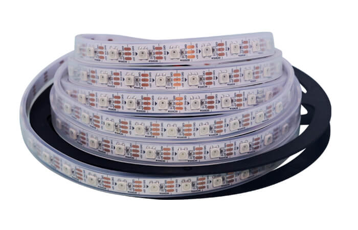

WS2812 ? To cascade a lot of LEDs ?
Regards, Dana.

Google this, lots of hits -
"arduino ws2812"
Regards, Dana.
I came across a large WS2812 flexible panel for sale the other day, current consumption was listed as 75A with all LEDs lit :D
Needless to say, it had multiple power feeds, rather than just feeding through the WS2812's.
