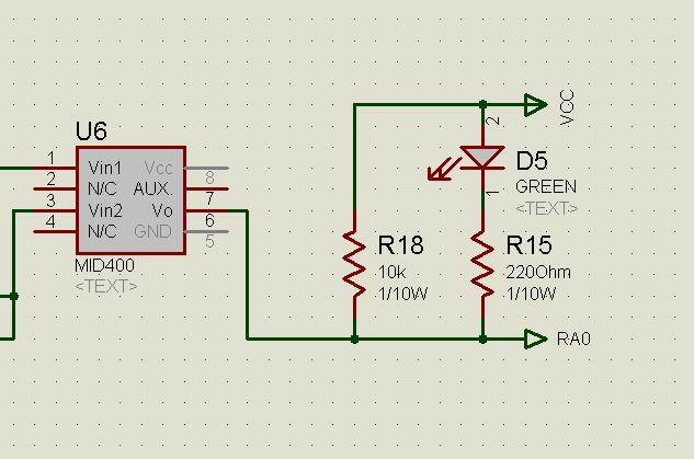

Please consider the attached circuit.
This is a Fairchild MID400 AC monitor IC. When AC is applied to its input (pins 1 & 2) its output (pin 6) goes low. The output is being monitored by a GPIO of a PIC with a 10K pullup. I added the LED and series resistor for visual indication of the output state.
The question is; do I still need the 10K pullup? Would the LED and series resistor pullup the output?
My thinking is that I still need the 10K as when the output is off the diode would not be biased past its turn on voltage and would effectively do nothing. Or not. :confused:
Thoughts?
EDIT: RA0 in the diagram goes to the PIC
EDIT2: I fixeed the schematic so that Vcc is at the top, per convention. Sorry for the confusion.

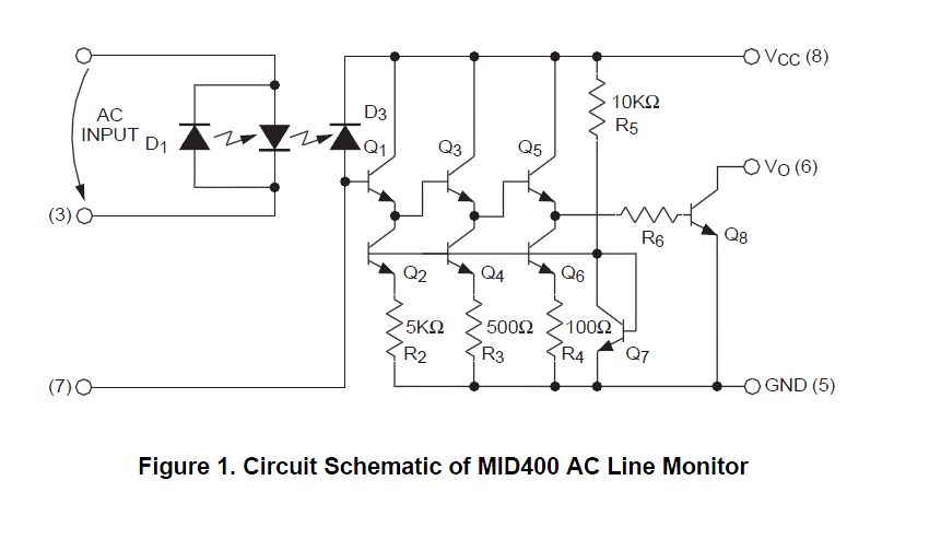

Its not the output of a PIC, its the output of a IC which is the collector of a NPN transistor. see attached internal circuit from the datasheet. It's being monitored by the input of a PIC.
EDIT:
THIS IS NOT MY CIRCUIT.... THIS IS THE INTERNAL DIAGRAM OF THE MID400 OPTOISOLATOR (U6) IN MY CIRCUIT.
Sorry for the confusion. My circuit is in the OP.

The MID400 can sink up to 20mA so that 220R/LED is OK, just omit the 10k.
Hi Eric,
I know that the LED will function fine, my concern is proper function of the PIC. The primary function of the MID400 is to monitor an AC line and provide status to the PIC. The LED was added later in the design.
So are you are saying that the LED and series resistor WILL pull up the output of the MID400 (when "OFF") to a high enough level to be recognized by the PIC as high?
The LED will cause a voltage drop of a volt or two. So, the voltage you will sense will be VCC-Vd, where Vd is the drop of the LED. I'd just leave in the 10K resistor. I don't see that it hurts anything to have it in there.
The LED will not pullup high enough for the PIC to see a logic high. Use the 10k pullup resistor to do it.

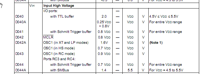

Isn't a PIC made with high-speed Cmos like 74HCxxxx? Their logic high is a minimum of 3.5V. If the LED is a visible one then it will not have only a 1.2V drop of an IR one. If it is red it might drop 2.0V and the logic will be 3.0V which is not a valid logic high. If it is an old 2.2V green LED or a new 3.5V green, blue or white LED then the LED voltage drop is much too high.
Using a green led, with a Vfwd of 2.1V will, with leakage current will pull up the HiZ input of the PIC to 3.6V.
As the Vmin high is 2V, the PIC easily sees the 3.6V as a logic high.

Thanks for the effort Eric. I think for the price of the resistor I will leave it in. One less part of this design to worry about.
This a clip from the PIC datasheet.
If you dont believe me, you are welcome to come and visit and see it working...
The tea/coffee and doughnuts will be on me.:)
