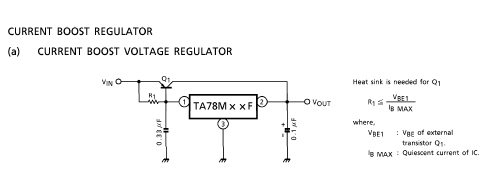

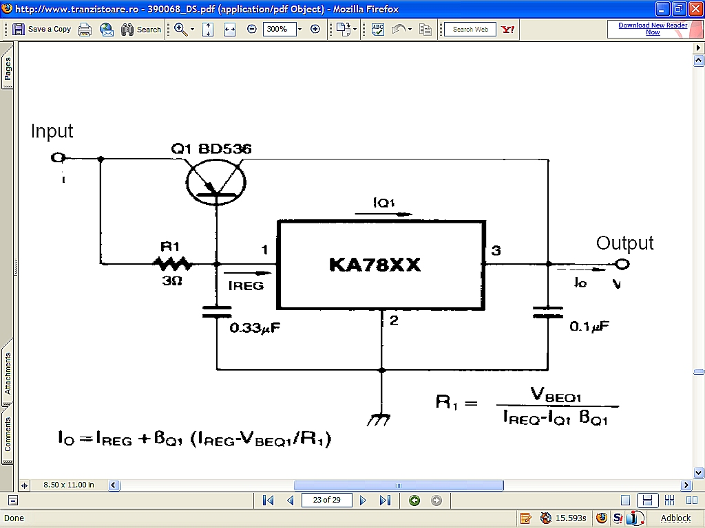

Some regulator datasheets show a schematic where they use a transistor in conjunction with the regulator to provide more current then the regulator itself can supply. Could this be used with a LDO regulator?
Yes it can but it needs to have an additional 2nd transistor to provide current limiting.
Also not that you have to add Vb + Vce at the desired current to the dropout voltage.
I would add only |Vbe| to the drop-out voltage of the regulator, ΔVreg.
And |Vce| = |Vbe| +
ΔVreg when the transistor is on.
EDIT: as far as I know, there are LDO regulators that can source 750 mA or more, as the OP requires.
