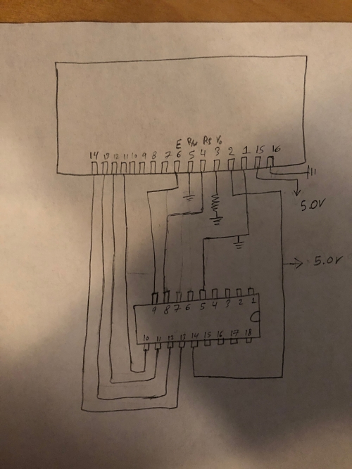

LCD with PIC16F1847
Sp1cyChef
Hello
I'm trying to control an LCD in 4-bit with a PIC microcontroller using the example code provided in the datasheet of the LCD
but I'm having difficulty understanding what to put instead P1 in their example code.
P1 in my code is in both the header and main files
I'm using
1- PIC16F1847 microcontroller
2- NHD-0216BZ-FL-YBW LCD (datasheet attached)

P1 is whatever output port you are using - Port B / LATB, from another part or your code.
You appear for be using B4 - B7 to link to the display D4 - D7
As you are using other bits on the same port for the control lines, you need to AND the data with 0xF0 if there is any possibility that the low bits are non zero - then set the control pins as appropriate.
Does delay work with fractions? I've never seen that. If your compiler has __delay_us() you are better off with that, or just do a couple of dummy operations, int a,b; a=b or similar, to allow a short delay during the E pulse.
Don't forget the R/W signal !

Thank you for the reply.
I'm using MPLAB X IDE v5.25 with XC8 as compiler
How would your code be for P1?
I also changed the delay to be a whole number. R/W is grounded I didn't forget about it

I have not tried using such code because I'm new to LCDs and I'm trying to develop an understanding to the basic code provided in the datasheet so I can modify it when needed.
Your assumption is correct R/W is grounded
I tried your code it's a slight improvement. A question mark and a blinking cursor came up but it's stuck there.
With my code I could only make a blinking cursor show up.

Here is the schematic and I double checked the connections. Everything is connected according to the schematic. Your code gives one question mark.
121026
With the last code I uploaded I'm getting a line of question marks, I don't know if that helps.
(RB1 is connected to RS) is wrong, it hasn't been updated. Follow the code
A line of question marks means it's getting data but is somehow corrupt. Could you possibly have a bad joint on one or more data lines?
Edit, In InitLCD, if you change the line command(0x2c); to command(0x20); do you only see 1 line of characters?
Remember what I said about writing the whole port clearing all the control bits?
The RS line was being set to 0 / low each time you wrote to the port; that's OK for the command as RS should be low, but it messes up the data write.
