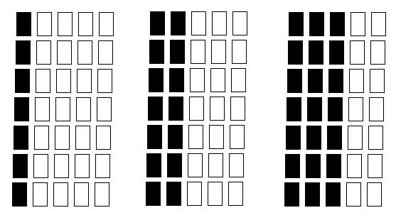

I tried hard before posting this thread. I'm looking for sort of LCD User defined characters similar to the attached schematics. I tried to manipulate Nigel's LCD tutorial, but not succeed to get more than what specified in HD44780 predefined characters. Is it possible to do or not. Thanks

To write to the user defined characters you have to send command 0x40+(character address) followed by 8 data bytes.
So, sending command 0x50 (0x40+2*8) and then sending data 0x0e,0x11,0x11,0x11,0x0e,0x00,0x00 will result in character 2 being defined as a lower case o at the top of the character so it becomes ° and you can do 27° etc.
Check the EPE LCD tutorials, they explain how to do it.
Thanks i've found it at:
i'll study it carfullya and ask for help if neede.
Thanks Nigel,
Thanks Mike.
