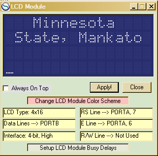

@ Aussie Susan: thanks for the information + advice. I was starting to wonder whether I was barking up the wrong tree completely.
@ Thanks again, Eric. - I'm going to try to post the code using code tags.
Current connections:
RS > RA7
E > RA6
D4 > RB4
D5 > RB5
D6 > RB6
D7 > RB7
RW = not used - code works off delays and doesn't check busy flag.

- I've adapted this code for use in the 16F819. It is based on one written by Sanchez and Canton in "Microcontroller Programming the Microchip PIC". Their original version was written for the 16F84A.
The only significant changes I've made were to use the internal oscillator and move the RS and E lines, the rest is pretty much as they wrote it including their explanatory comments.
Analogue.
Runs OK in the Oshonsoft simulator.

Hello Eric. Thanks. - It works fine with the current connections, but when I try to use RB0 - RB3 to connect to D4 - D7, instead of the PORT B higher 4 bits, the message doesn't display at all.
- Any ideas as to what might be going wrong, please?
Analogue.
