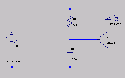

S smanches New Member Jan 26, 2010 #1 Using minimal discrete components, how could you change the behavior so it acts like a comparator, instead of ramping up? View attachment StartupDelay.asc Last edited: Jan 26, 2010

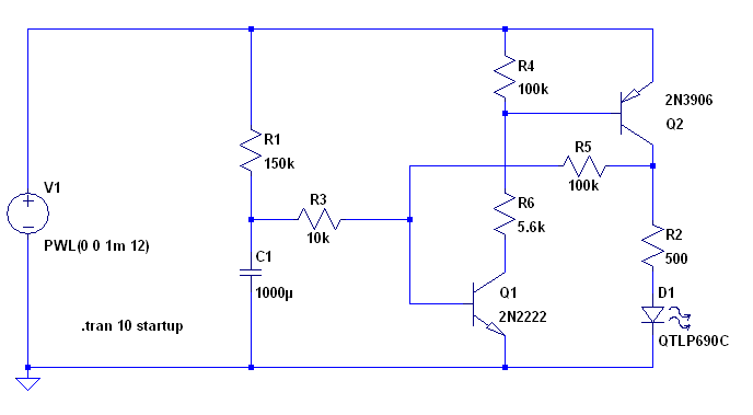

Roff Well-Known Member Jan 26, 2010 #2 You can add a few parts to give you some positive feedback. Attachments StartupDelay1.asc 1.5 KB · Views: 138 startup delay with pos feedback waves.PNG 11.4 KB · Views: 169 startup delay with pos feedback sch.PNG 14.3 KB · Views: 277 Last edited: Jan 26, 2010
S smanches New Member Jan 26, 2010 #3 I knew it was easy, but I don't have enough op amp type experience to figure out where to start. Thank you very much!
