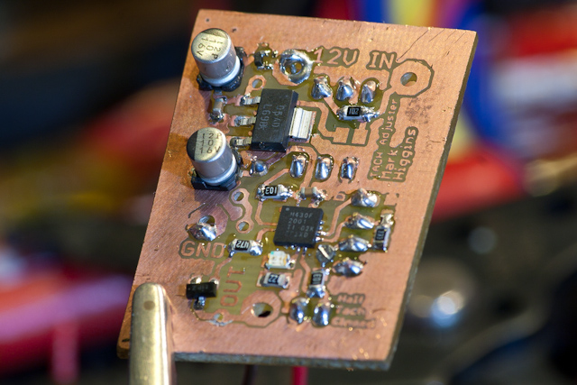

I've primarily used the f2xxx series as they support the EZ430 spy-by-wire programmer debugger. I've used these for small applications as Code Composer Studio has a 16k code size limit for the free version. The chips themselves are 16bit and easy to program and are meant for low power application.
I've made small RF devices and lately a freq adjuster for a motorcycle gauge retrofit.

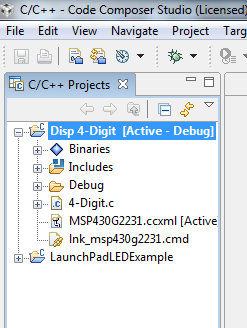

I could also use a hand trying to change projects in CCSv4, please? How do I switch from the Disp 4-Digit project to LaunchPadLEDexample project?
Oops! I found it by right-clicking on the Project name. Sorry to be a pain guys...
