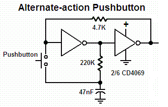

Here is a simple toggle circuit. 3 of the circuits can be made with one IC. It has built-in debounce for the pushbutton.

Afternoon, I've come across this circuit during a google search and i would like to ask some questions if that would OK?? i can start a new thread if required depending on the answer i get as i don't wish to hijack this one (even if it is from 2007) basically i am looking to use this circuit to convert a door switch (Van side door) in to a momentary switch. would there be any issues with this circuit if it had the 12V supplied to it all the time the door was open? i know you talk about toggle switches further up but i was just hoping to clarify.
Thank You in advance
Not at all

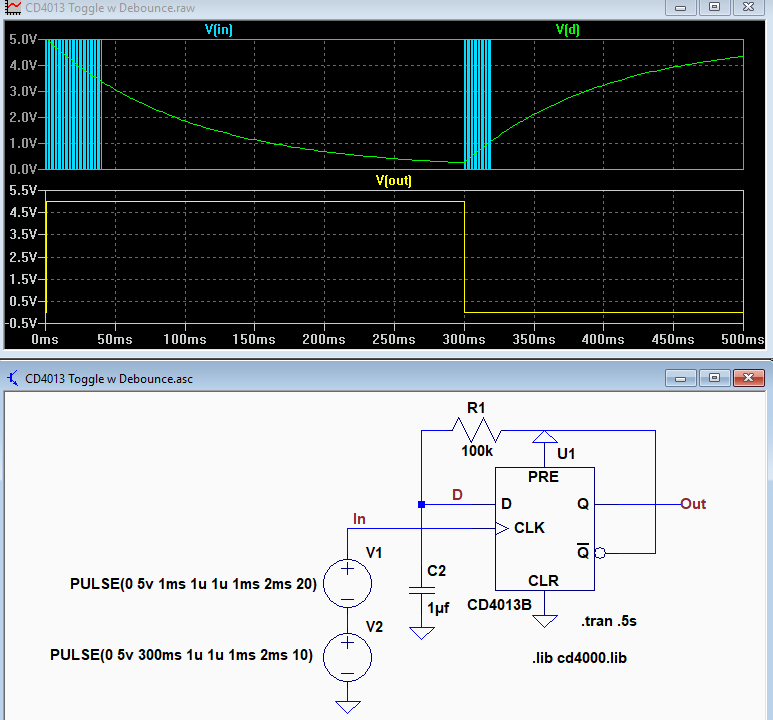

I prefer the debounced toggle circuit below using the CD4013 D-FF.
It uses an RC to delay of the D feedback signal to prevent the FF from toggling more than once during the switch bounce time.
It uses only one R and one C, and doesn't degrade the clock signal rise-time.
For the values shown, the debounce lockout time is about 70ms.
