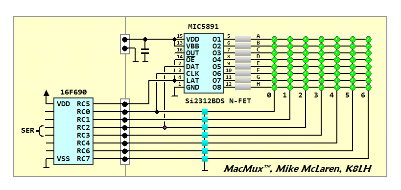

I would recommend something simple and hefty on the display side with full brightness and PWM brightness control. You should get an idea from the crude drawing below for the 15-pin LED wiring harness. You might consider four push buttons in a "diamond" pattern and a 2x16 LCD display for the user interface or perhaps something as simple as lighted push buttons switches. Power budget for the display below would be a maximum of 960-ma.

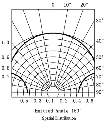

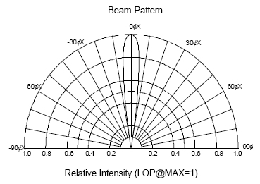

There are many different types of LEDs. I attached two pictures of viewing angle. 150 and 7 degrees.

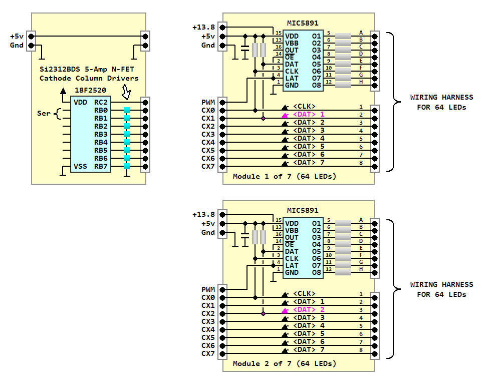

140 LEDs per side, oh my. A modular approach might work. Below, a slightly different controller with a 9-pin buss to multiple "driver" boards, each "driver" with 16-pin connectors for wiring harness to 64 LEDs (8x8 column/row).
You'd use one driver board for the 48 or 50 LEDs on the transom and three driver boards (up to 192 LEDs) for each side of the boat.
LEDs are multiplexed at 12.5% duty cycle so current budget for seven driver boards should be something like 5.6 amps but that's off the 13.8 vdc buss. The regulated 5 volts that the controller and driver boards need should be handled easily by a single 5v/1a linear regulator.
The hardware is easy. It's the software that will take the most effort.
