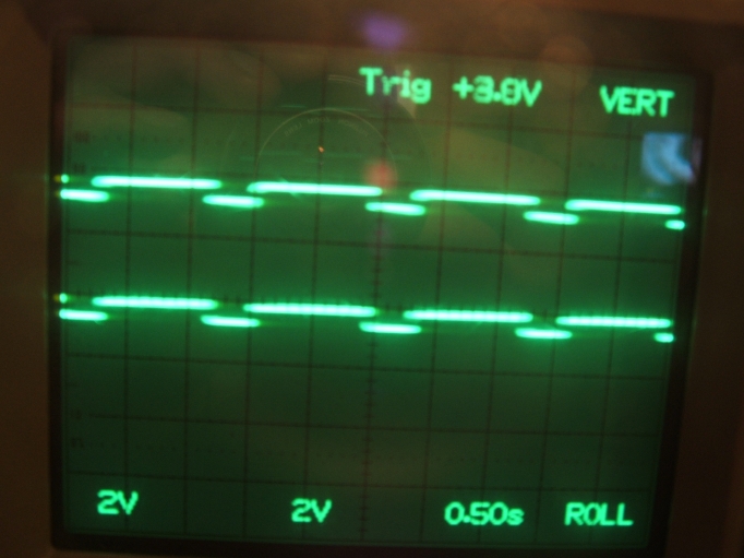

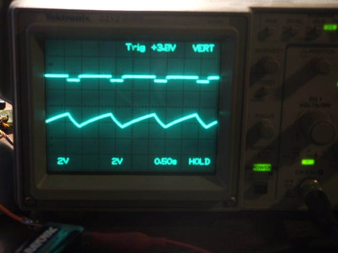

I found my other probe so I can look at 2 outputs at once. They all follow the 555. It dosn't matter how I connect the probes. The trace in the picture below is what I get.
Picture number 2 is one output against the 555 output. I don't know why my 555 has such a strange wave. I have 100µf cap on it. Bigger then is normally used I think. Maybe thats why:confused:
I am a novice with my scope, but it dosn't look to me like the 297 output travels the full 0-5v.
I did order 2 of these chips. I tried both and they do the same thing.

the pic1, thats output from what 2 pins of 297?
I don't recall, but I tried all the outputs and could't get a change.
Eric, right now all the 9v is powering is a 555 timer, small led to give me a visual indicator the 555 is running and the L297. I back off with the 298 and the actual motor until I can be pretty sure I have the 297 working.
andy, strange ... if that's 4 and 7 then ok but if that is 4 and 6 for e.g. that;s problematic
if your scope features different ground for 2 probes you can connect
probe1 gnd to 4, tip to 6
probe2 gnd to 7, tip to 9
if not then connect probe1/2 ground to 2 and tips to 4 and 7 and then let it "clock"

I had a few minutes before I left for work thismorning, and I connected a 12v 3 amp power supply to the 7805. The 555 still has the goofy wave to it. I wouldn't think that would be the problem, but it sure has me wondering.....

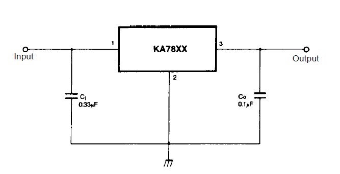

I think that the 7805 needs capacitors. Otherwise it act strangely.

:eek: I deserve a darwin award........
I had small ceramic caps on the 7805, but didn't have anything else for capacitors on the power supply.
After spending an hour trying every conceveable combination of the CONTROL/INH1/INH2 to get a output like arhi's simulation I grabbed this big ole' 10000 uF cap that was rolling around on my bench and stuck it across the power rails. Ta da. Output now looks like arhi's simulation.
live and learn I guess. Working on hooking the L298 back up now.....
Now the 555 has a nice clean square output too.
