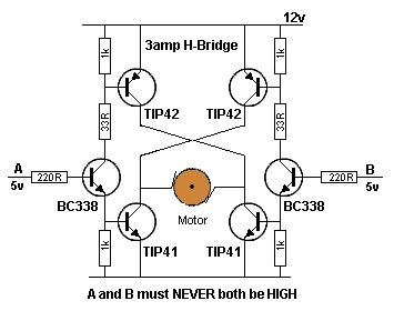

As for couple suggestions for control:
If you need two-directions, you need more that one diode, here's one variation for H-bridge, with benefit that there is no situation to kill drivers due bad control sequence (well okay, if a&b are both high..., that kills stuff):

Hy Fezder,
Just put four 1n400x rectifier diodes in the bridge: anode to PNP transistor collectors and cathode to positive supply line and cathode to NPN transistor collectors and anode to the zero volts supply line.

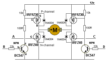

Oops forgot those, like this fashion?
Hy Fezder
Thought you had missed the diodes in the case of bipolar junction transistor bridge but in the bridge circuit above the diodes are not necessary because the MOSFETs already have parasitic diodes with a current capability comparable to the drain current of the MOSFET.

One method used on a small motor such as this if dynamic braking is needed at switch off is to turn ON both the bottom Mosfets.
True, I was just lazy to look for BJT :P and maybe they forget those diodes from fets hehe...
