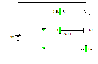

Here's a simple variable constant current circuit for varying the brightness of an LED.
The maximum current is about 20mA.
