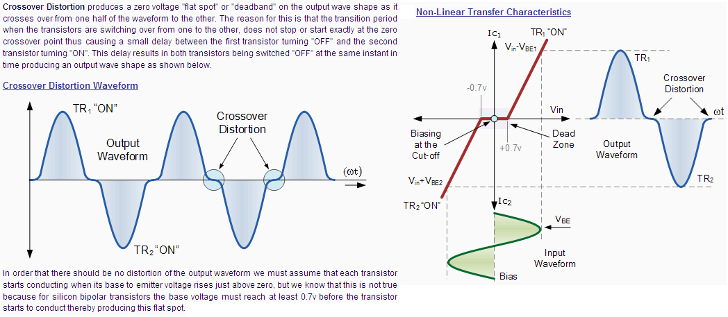

what is "crossover distortion"
Look at its description in Google.
It sounds like a buzz attached to speech or music. It is caused by a class-B output stage which does not have any idle current so there is a dead zone around 0V and the signal needs to be +0.7V or more to turn on the NPN emitter-follower and needs to be -0.7V or more to turn on the PNP emitter-follower at the output of an audio amplifier. Crossover distortion is eliminated by biasing the output transistors a little with a small amount of idle current (then they operate in class-AB) so there is always a transistor conducting with no dead zone.

Hey, Audio McDuck: very good explanation of crossover distortion there (the illustration). Where did you get that graphic and text?
I entered Crossover Distortion into Google and this site was the 5th link:
