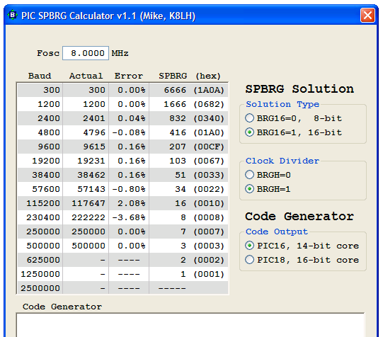

You can get 0.16% bit rate error for 38400 baud and 8 MHz INTOSC by using BRGH = 1 and either BRG16 = 0 (SPBRG = 12) or BRG16 = 1 (SPBRG = 51).
